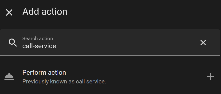

The whole point “Does custome card auto-entities still work with the new ‘call-service’?” is incorrect since the auto-entities card simply passes a list of data into a defined card (entities in Entities card, cards into Horizontal stack card, …).
I fully agree, this was the beginning of my journey where cards still talk about " "action: call-service" and in automation this is renamed into “Perform Action”:
This in combination with the badly working “tab_action” made me jump to a wrong conclusion. Will adjust the question but if you know this answer feel free to share.
