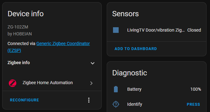

My Hobeian ZG-102ZM has entities for vibration, door, battery and sensitivity. But “door” is never on. There was nor magnet in the package, just the sensor itself.
Same here, with ZHA it only shows the binary sensor (open/close) and not the vibration one. I’ll try it later with z2m

Nope, it still works like contact sensor only.
Not explicit quirk means that it uses default ZHA collection.
