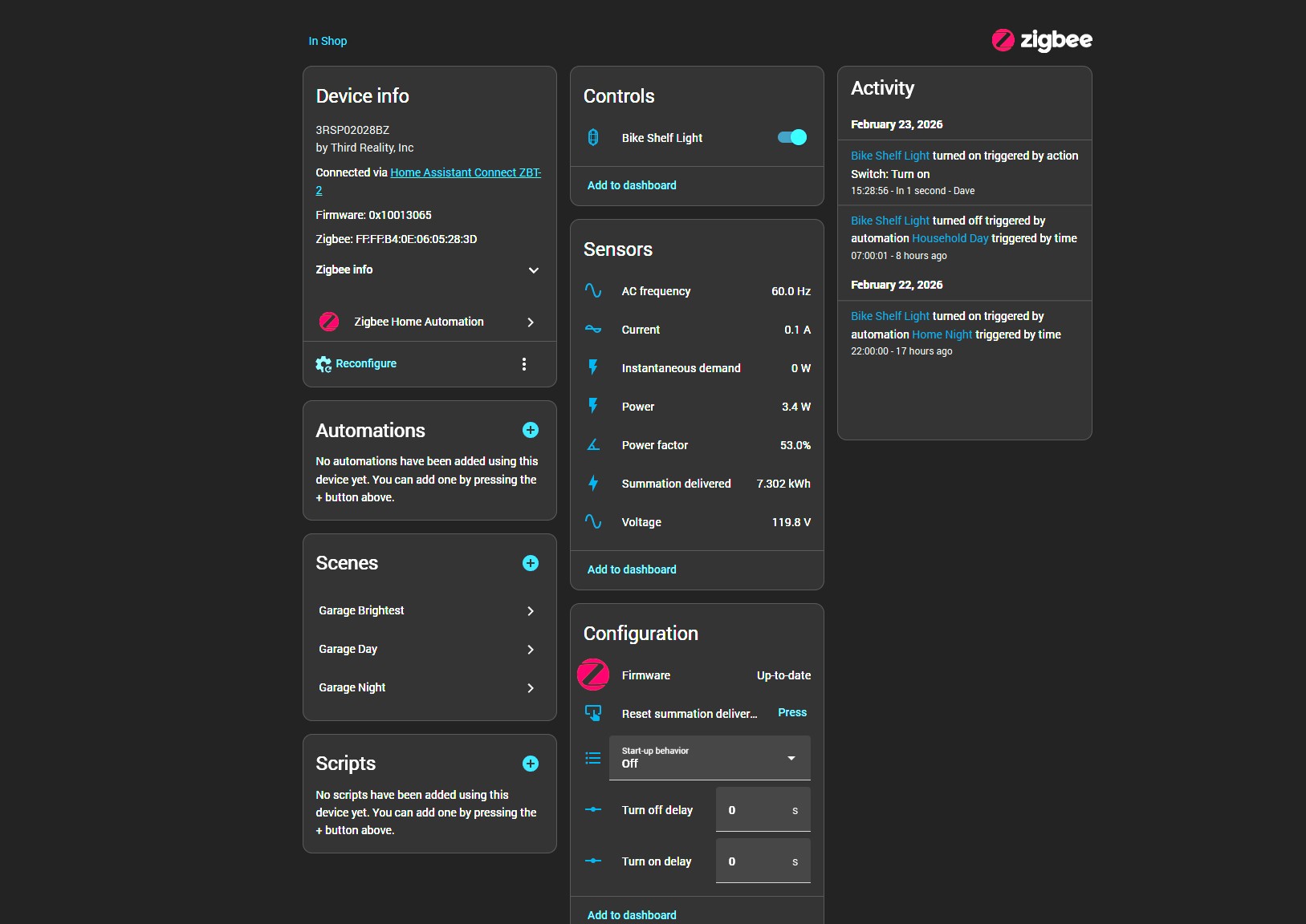

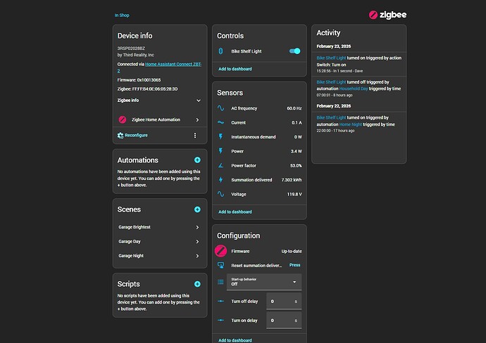

I have these all over; they work great, integrated perfectly with ZHA (ZBT-2), and serve as repeaters, obviously. They show my power consumption, no problems whatsoever with LEDs, in fact, in the screenshot I attached, the plug is powering a couple of LEDs. If you’d like, I’ll turn them off, and show you a second screenshot showing zero power draw.
Anyway, best of luck, and have fun!

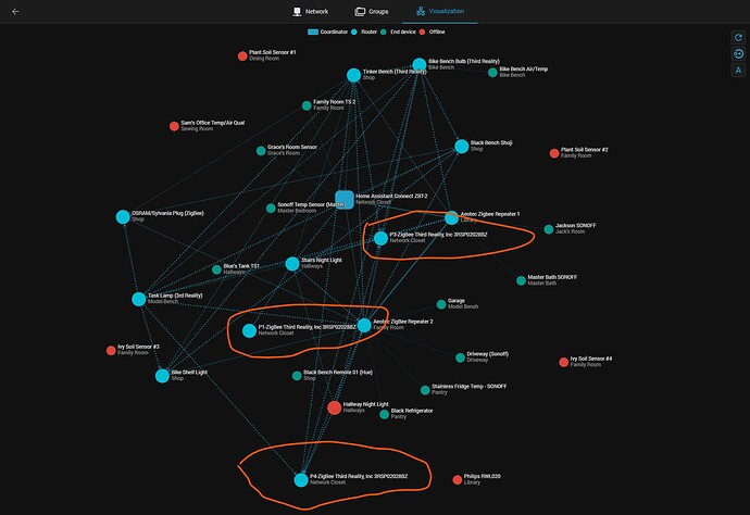

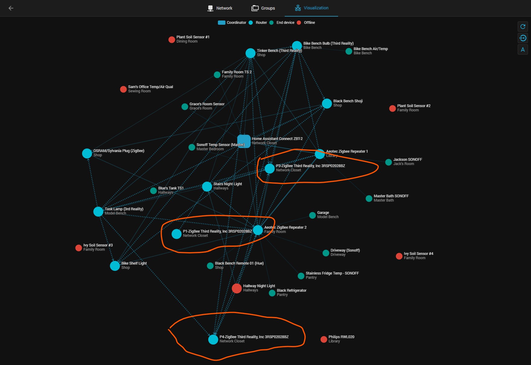

The devices circled in red are a couple of the 8 (I think) of these plugs I have. They are good Zigbee net devices. Notice the complex connections they make.

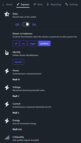

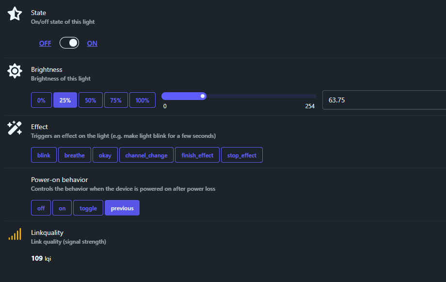

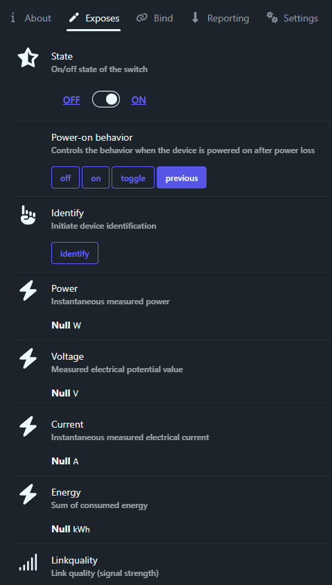

These plugs are now available in store, and via their website. Just picked up 3 just now for £6 each. Z2M can only turn them on/off, but there is an LED brighness option available so you can turn it off, but I cannot seem to get that to work currently - setting to 0% turns the socket off.
You forgot the brand / model name.
Sorry, this is for the new Grillplats from Ikea Here
There is no real support for the power settings at the moment, I tried to add a manual converter file to Z2M and that gives me on/off in HA, but I do not see power. Need to see if someone finds the correct settings, and whether power is shared when in Zigbee mode
The latest Herdsman release here only provides on/off options.
