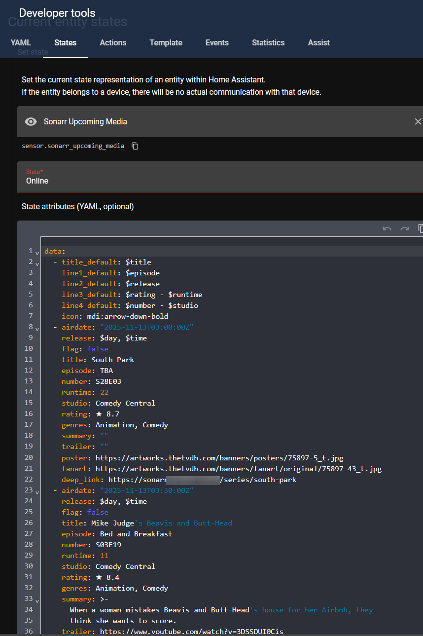

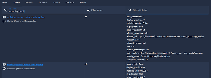

Hi @Ltek can you post a screenshot of what you see under Developer tools/states for your sonarr or radarr entities? You should see something very similar to the screenshot below if your Home Assistant instance has access (and the correct paths) to your sonarr and radarr URLs:

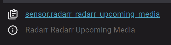

sensor.sonarr_sonarr_upcoming_media was empty BUT I found that the entitiy did not exist; the entity is… sensor.sonarr_sonarr_upcoming_media
same for Radarr.
I think this is what the integration does when you add a name to the config / entry?
Maybe I missed it but did not see that in the wiki/docs anywhere.
I removed the extra .sonarr and its working now.

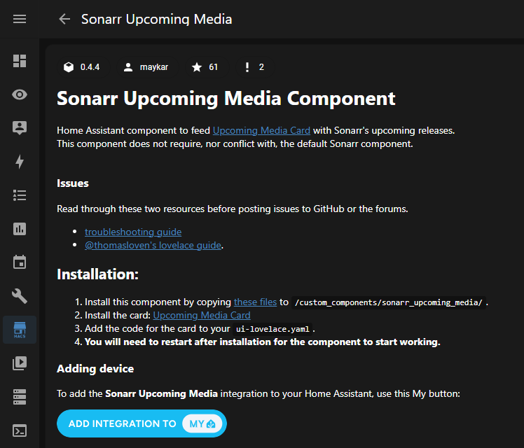

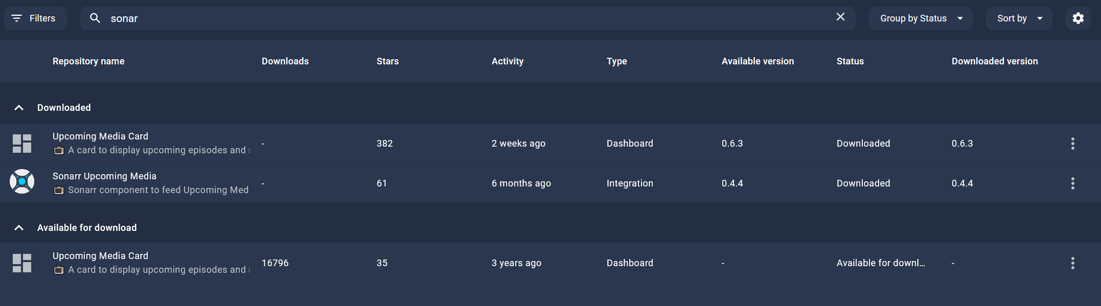

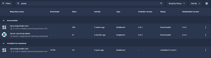

This is how it looks now in HACS with the specific versions etc:
Paul, please note that the download button in HACS is NOT a replacement for the below “ADD Integration button”. You still have to download the integration from HACS like always.
The blue button below is just a shortcut; it does the same thing as: Settings → Devices & Services → Add Integration and pick Sonarr Upcoming Media
Since you already installed and configured the Integration, can you go back to the below folder and edit the file called manifest.json in that folder?
/config/custom_components/sonarr_upcoming_media
… and tell me if the contents of that file show precisely what you see below, especially the “version”: “0.4.4” line.

Not sure what you’re doing differently, but getting the following error is a strong indicator that there is something still wrong with your Home Assistant setup: “This integration does not support configuration via the UI. If you followed this link from the Home Assistant website, make sure you run the latest version of Home Assistant.”. I’m guessing you already have a recent version of Home Assistant?
The manifest is showing version 0.4.3
Same as it is in the repo on github in the manifest file: sensor.sonarr_upcoming_media/custom_components/sonarr_upcoming_media/manifest.json at fd32a345c4ca48129dc36e879532d1842ed93211 · custom-components/sensor.sonarr_upcoming_media · GitHub
Also 0.4.3 in there

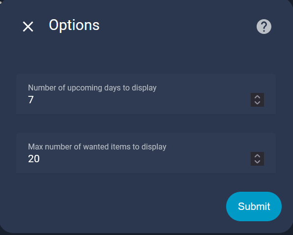

In the meantime a tvshow should appear in a card (in the sonarr integration i set the configuration to 7 days).

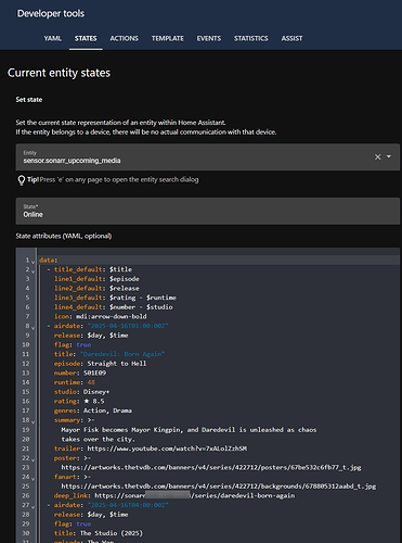

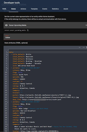

Hmmm looking at it again and i cant even find an entity with the name “sensor.sonarr_upcoming_media”. Shouldn’t this be created automatically?
EDIT 2:
Something (still trying to make it work here :P) i did find was this when checking the entity. State “off” sounds for me wrong. But no idea if its correct or should be something else?

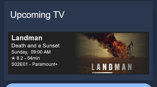

No idea why but now the “add integration” button did work and showed a popup to configure it (and created the entity).
But no idea why… Nothing changed or i edited (only the log line in configuration. but that one still did nothing before)
Now an episode is showing on the dashboard:
Still no clue why it did the config now… :thinking:

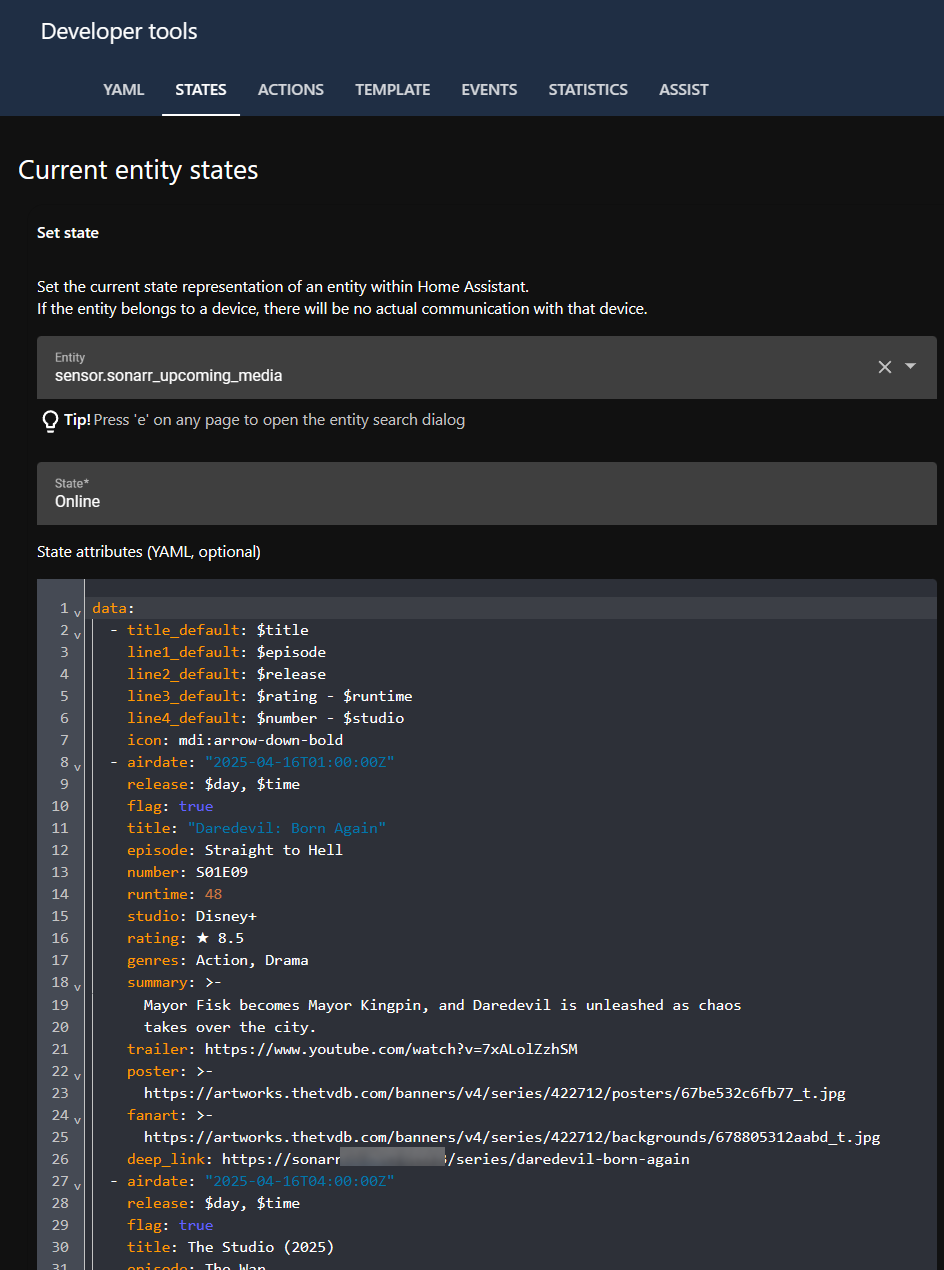

TIP: An easy way to tell what data is being received by this integration (or any other similar sensor) is to go to:
Developer Tools/States; and, type sensor.sonarr_upcoming_media as the entity. For example, mine looks like below (the first 2 items):

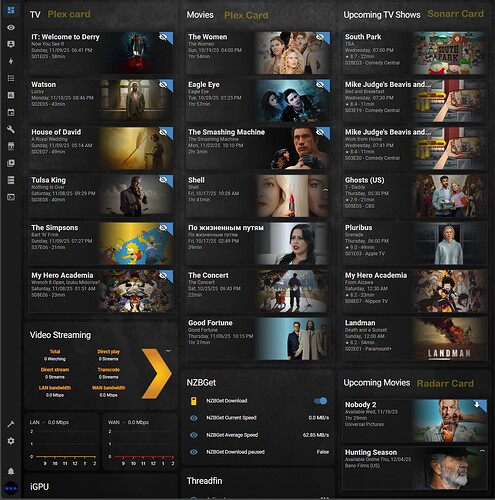

PS: Once you get more familiar with this stuff, you can also try some of the other really cool Integrations for Upcoming Media Card:
Plex - Sonarr - Radarr cards:
Trakt cards:

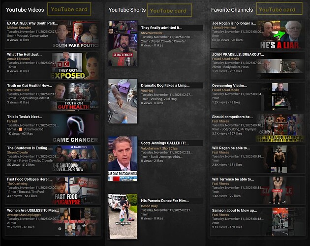

YouTube cards:
