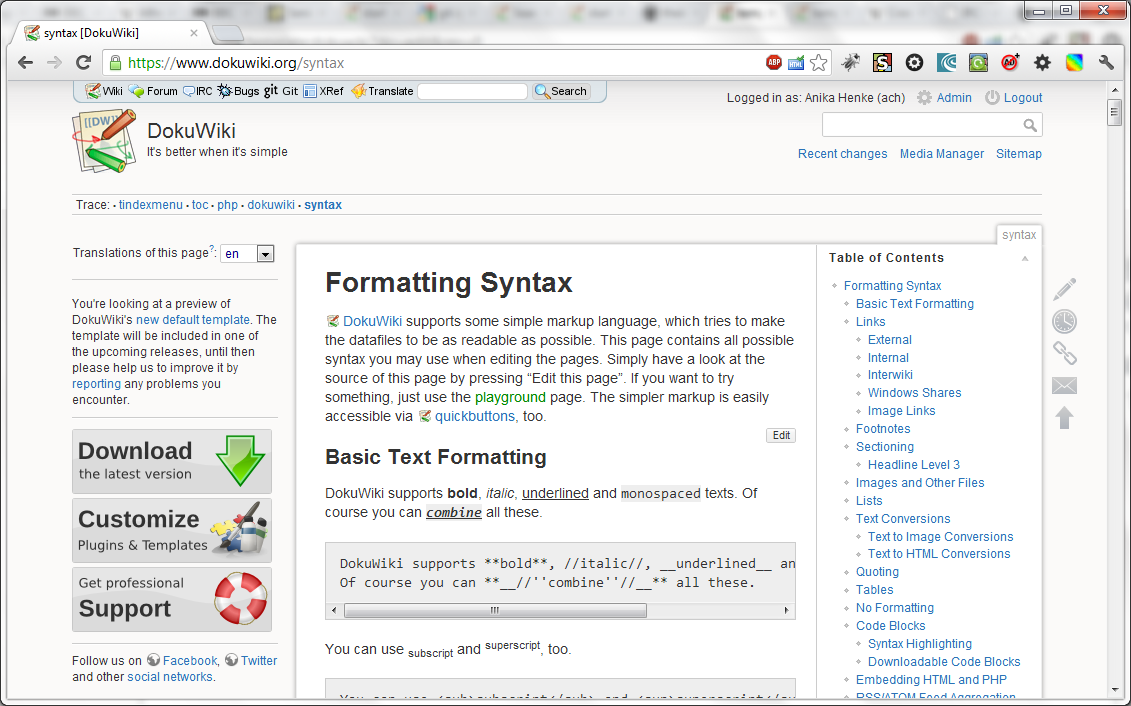

What is DokuWiki?
DokuWiki is a simple but powerful wiki that works without a database. It’s perfect for documenting your smart home setup, automations, device configurations, and anything else you want to keep notes on.

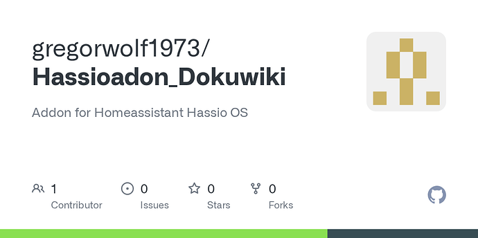

Or manually add this repository URL in your Add-on Store:
https://github.com/gregorwolf1973/Hassioadon_Dokuwiki
