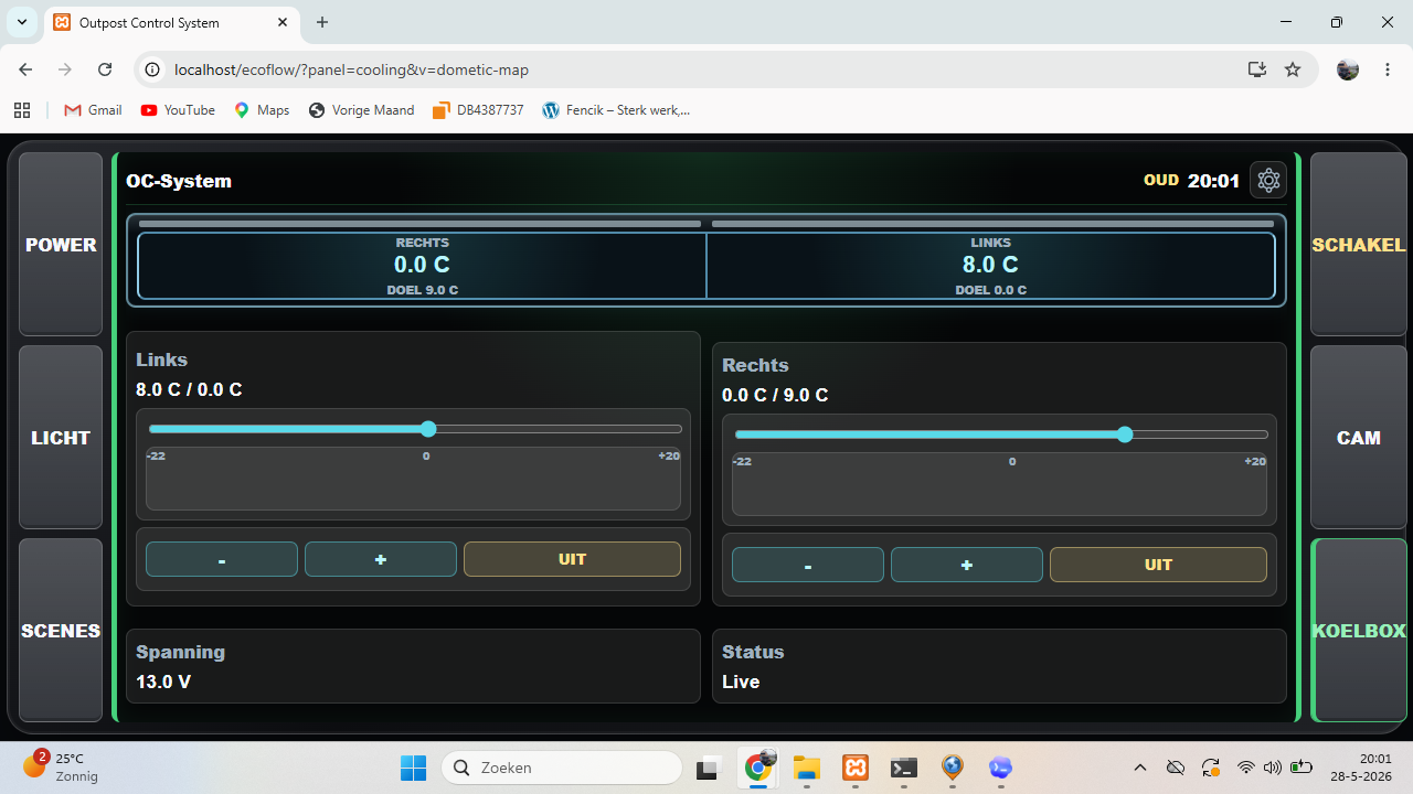

I am building my own 4x4 off-road control center, including the CFX3 Bluetooth. I can view and modify my CFX3 via the Raspberry Pi and Garmin Overlander.

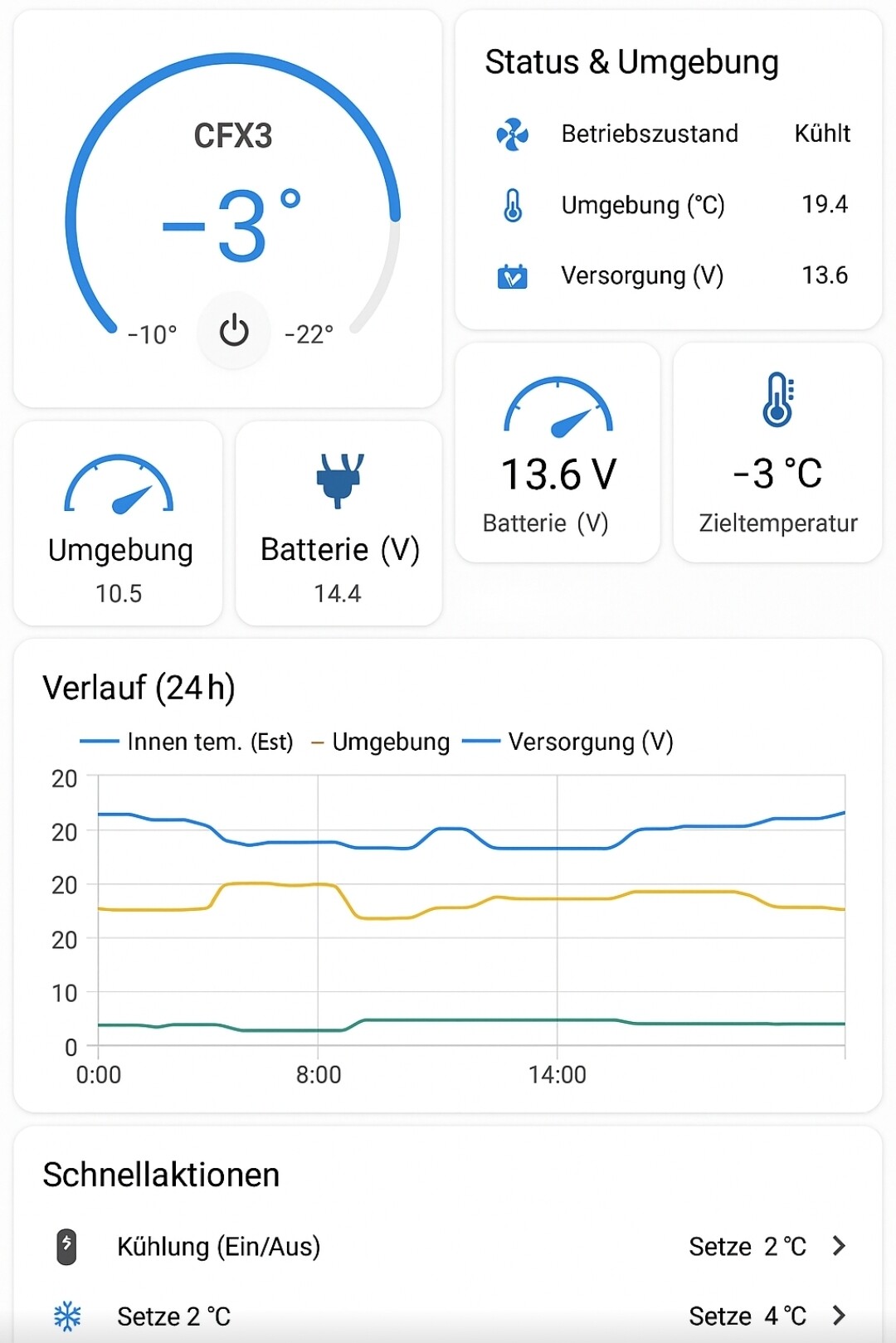

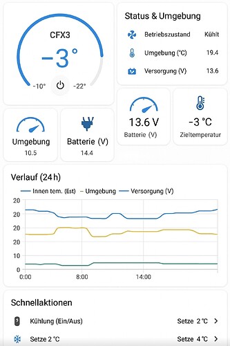

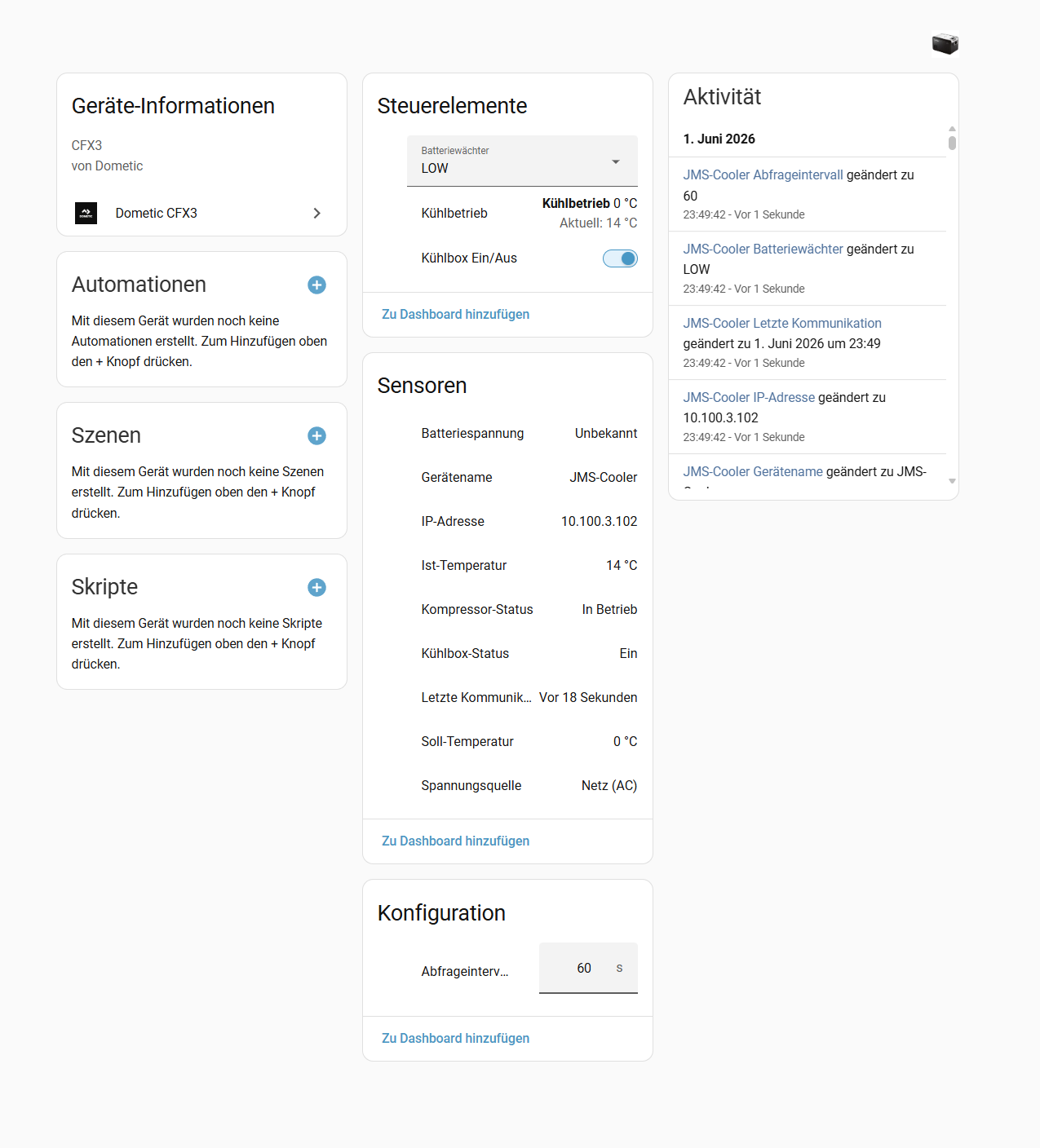

I was looking for the same thing and ended up creating a Home Assistant integration for the Dometic CFX3 series myself.
The integration communicates directly with the cooler over Wi-Fi using the local DDMP protocol, so no cloud service or Dometic account is required.
Current features include:
  • Local Wi-Fi communication
  • Temperature monitoring and control
  • Cooler power on/off
  • Battery protection mode selection
  • Battery voltage monitoring
  • AC/DC power source detection
  • Compressor status
  • Automatic discovery and reconnection
  • Home Assistant Config Flow support
The integration was developed and tested with a Dometic CFX3 35, but it should also work with other CFX3 models that expose the same local DDMP interface.
GitHub repository:
I'd be interested to hear from anyone who tests it with other CFX3 models.
