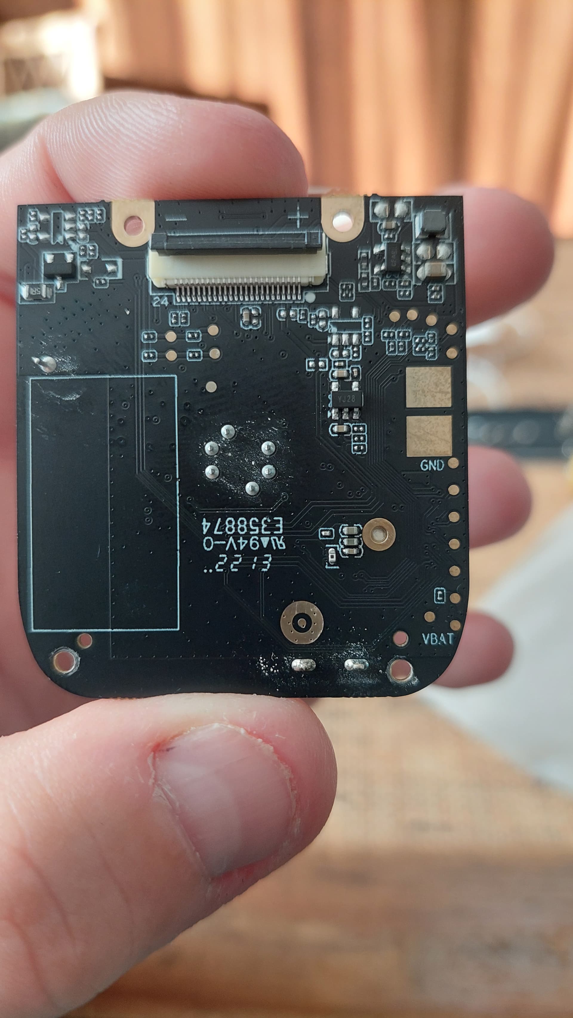

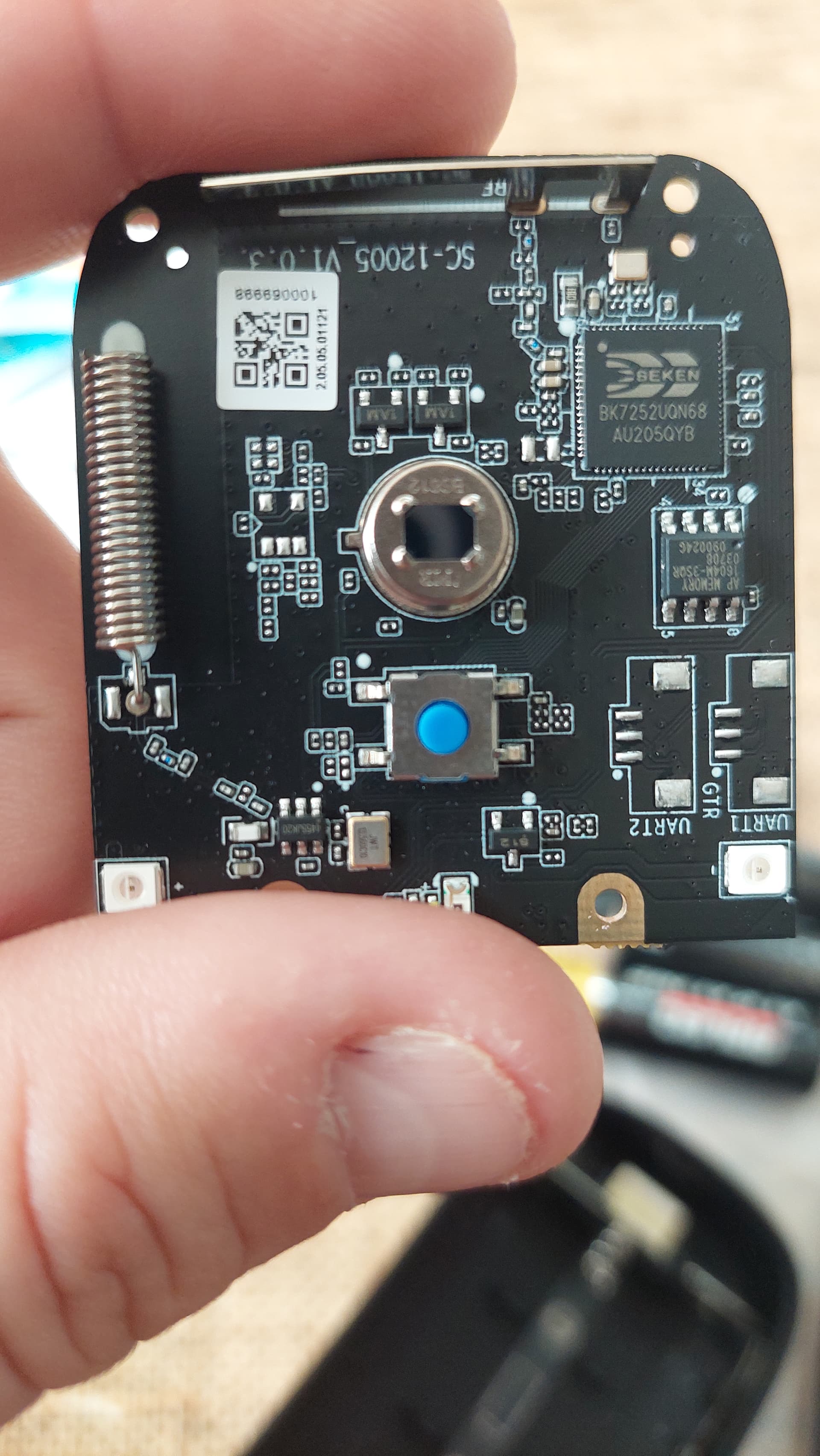

OK, so I ended up going to Bunnings and buying the cheapest Orion smart doorbell they had (DC10HA) so I could experiment… So far I haven’t done anything with software but just looked at the hardware.
Conveniently, the battery cover (3x AA) is also the entire unit cover, and the circuit board is exposed without opening anything that would void the warranty. Board is held in by 4 screws, which were too tempting and I took it out. :rofl: Here’s the photos…
  • SoC is a Beken BK7252. This seems to be supported by ESPHome if I decide to go that way.
  • Camera is a GC0328, which is not supported by ESPHome. It’s pretty garbage on paper, so I can’t imagine it’ll be much good in real life anyway. Stock Tuya firmware only uses it to take a single still image according to the instructions, so not super useful anyway. I’ll almost certainly be adding an IP camera elsewhere (or getting a better brand doorbell camera).
  • There is a PSRAM chip - AP Memory 1604M-3SQR - which is 16M-bit (2MB). I’m guessing this is used for the camera image data.
  • There’s also a generic looking PIR sensor, the main doorbell button and some LEDs. I would guess these are all connected to GPIOs as just basic binary ins and outs.
  • Indoor chime unit is triggered over 433MHz. I haven’t opened that yet. It does talk about “pairing” in the manual, so I assume they use at least a basic level of code matching, which means I probably can’t use this part with ESPHome unless the indoor chime unit happens to have a microcontroller I can reprogram too. Or maybe rig it up with one of the spare ESP01 modules I’ve got in my parts drawer.
  • The board appears to be designed to be semi-generic… Camera connector is wide despite only using a handful of pins. There’s a bunch of unpopulated places for ICs. And there’s a rectangle area marked out that could be intended for a LiPo pack to be taped on. I’m not sure if this is also used in other Orion doorbells or possibly even other Tuya doorbells.
I intend to try connecting it to Local Tuya and/or Tuya Local before doing anything dramatic like ESPHome-ing it. But I have doubts this will work because both say they don’t really support battery powered devices.
