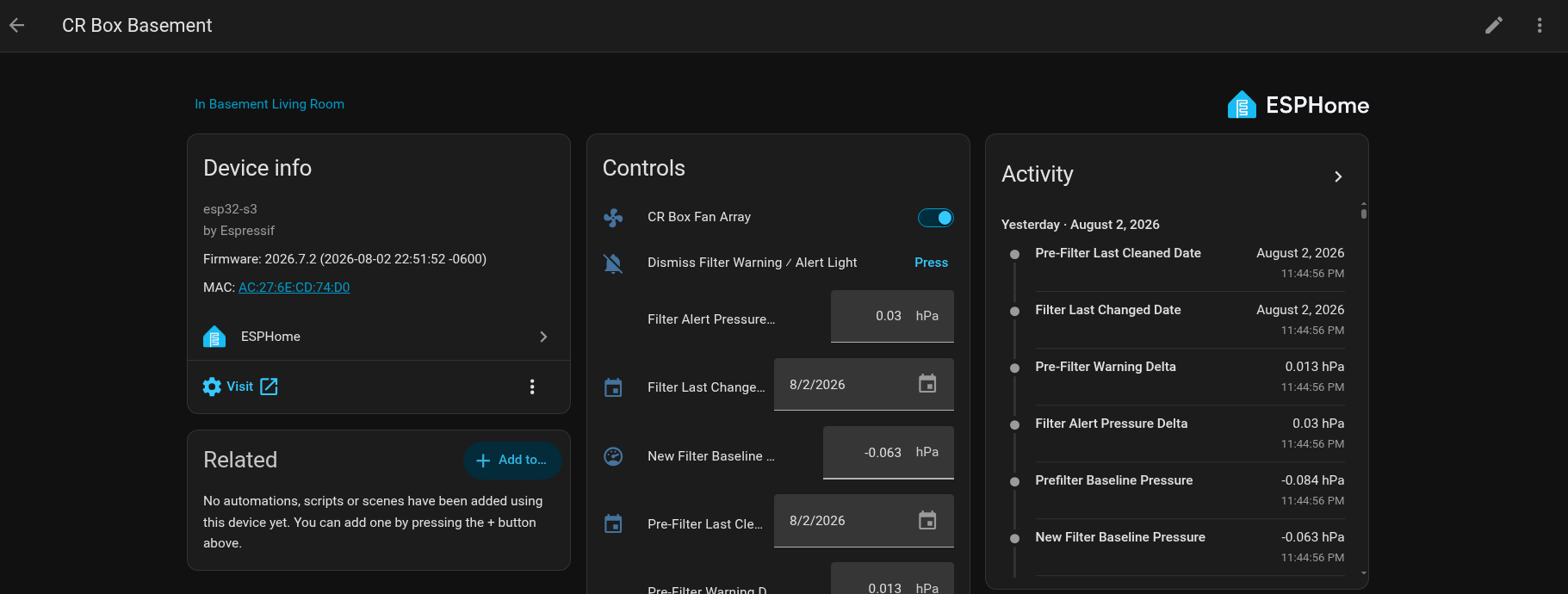

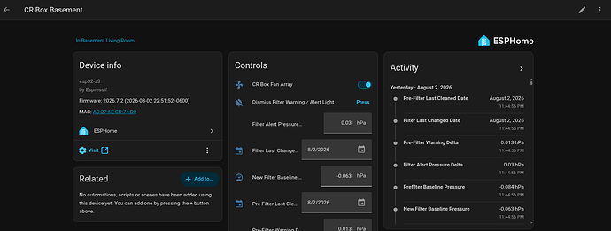

In the above example, the device is named ‘CR Box Basement’ and it then has several entities that have their own name.
