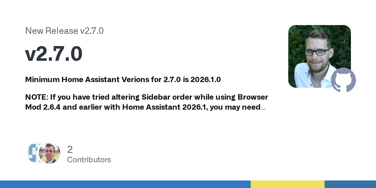

:eight_pointed_black_star: Finally found a fix for my TTS and media command that were repeated, by trial and error.
Two android mobile device had that strange behavior, one of them only started after a Samsung update, making it even harder to pinpoint the origin as the other is a lenovo tablette.
Hopefully not a coincidence as there is no mention in the release notes: Updating Browser-mod to latest 2.7.0 made TTS back to normal and command_media play-pause acting as expected. (was skipping to next song instead, had to go in Deezer - or swipe from top - for instance, in order to stop/pause)
Let’s see if it fixes it for anybody else as well :wink:
Unfortunately I don’t use Browser Mod.
Could be another HACS mod that interacts/listens to media… just guessing here
I’ll try a tts test after starting in safe mode when I get time, but I don’t have anything like that I can think of.
Well, false fix as it only worked a few times on both Android devices :unamused:
