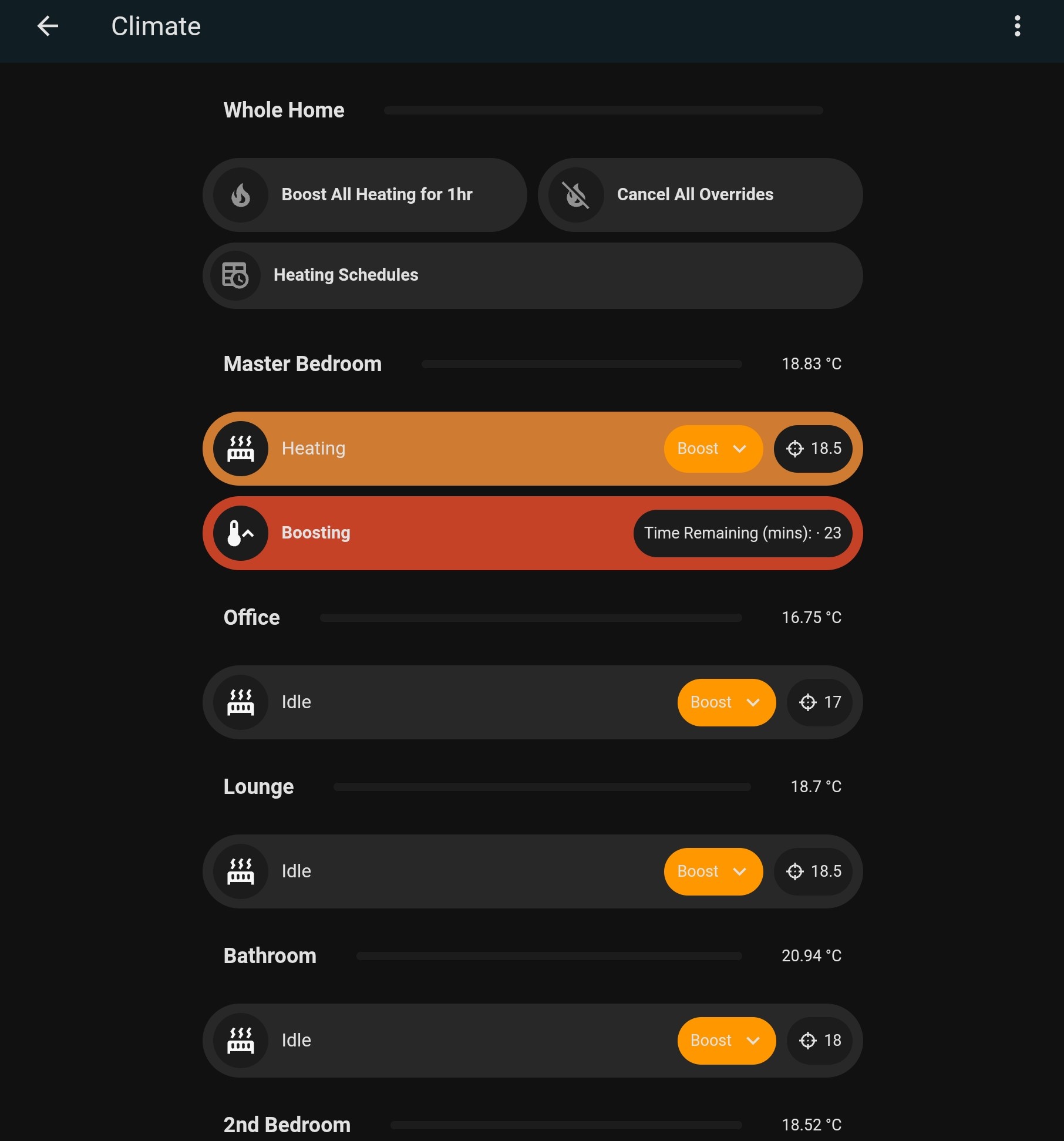

Recently switched my Nest over to the Drayton Wiser system and this integration has been really easy to set up, thank you to devs for making it so straightforward!
I’m using the external temperature sensor recipe/automation that is provided in the wiki, it’s been working well so far. One quirk I did notice was if the TRV was manually boosted and the external temperature sensor recorded an updated reading which was within the tolerance delta of the scheduled temperature, the automation would cancel the boost.
I’ve used a combination of helpers to work around this for now, but wanted to double check I’ve not missed anything obvious in my setup?
Somehow I managed to miss this recipe, so I am really glad you posted and brought it to my attention. @msp1974 this looks great!
No. It uses boost to manage reaching the correct room temp, so will cancel any boost you do manually if at target temp.
Happy for anyone to try and improve this.
Makes sense. My workaround was to create an input boolean for each TRV to track when the automation is the one boosting the rads, and a switch for each TRV which is true if said input boolean is false but the climate entity is_boosted attribute is true (i.e. boosted manually).
I then modified the automation to add an additional action which sets the input boolean to true if the temp delta is larger than specified (i.e. script is boosting), and a condition to the existing 2 conditions to check if the manual boost switch is false before proceeding.
If anyone has a cleaner way of doing this, I’d be keen to hear about it!
This manual boosting switch is also used to show a card which indicates if a radiator is being manually boosted.
