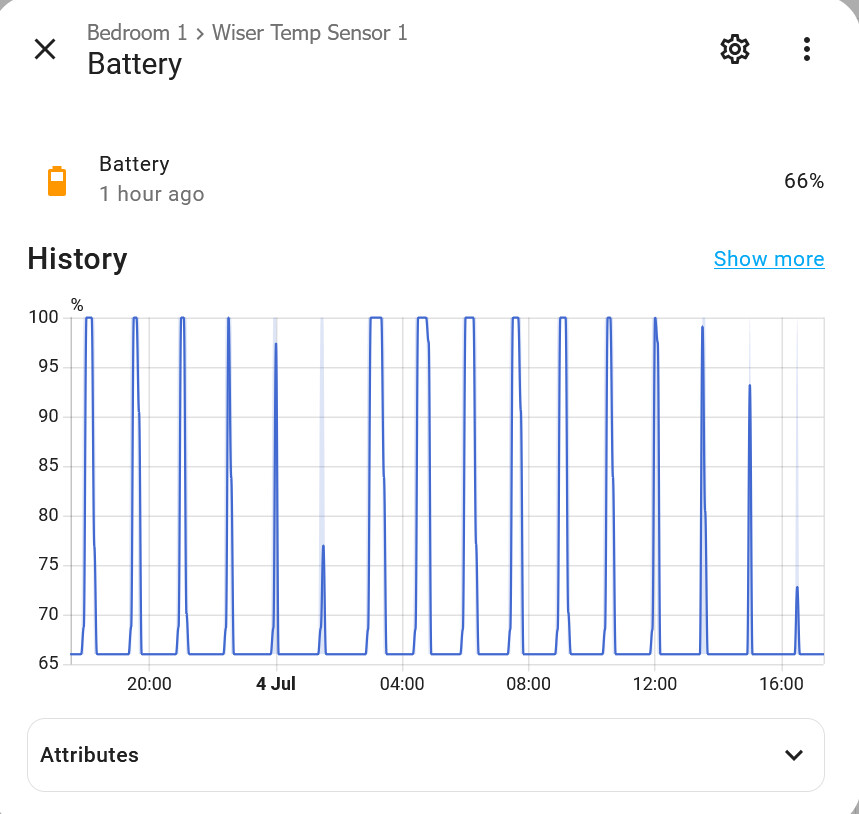

Schneider claim a 5 year battery life so how do they explain the battery level dropping to 66% after 2 days use?
Can they also explain why this behaviour has only started since the update from v1.6 to v1.7?

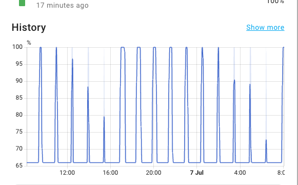

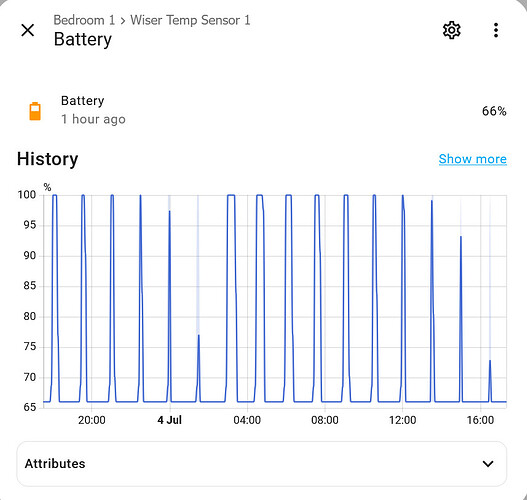

Just to add to the evidence. Here’s the battery info for my brand new Temp/Humidity Sensor running V1.7.5 firmware. It seems to have a period of almost exactly 90 mins, which is too regular to be simple coincidence

That pattern looks eerily familiar!
I’ve ask Drayton to not raise it as a “Feature Enhancement Request” but as a bug and they have agreed to. Fingers crossed someone looks at it and see a silly mistake they can sort.
Just to add, I have three of these Temp/Humidity Sensors all on 1.7.5, doing the same thing. I note that my three are NOT in sync with each other, in case that helps eliminate an external factor.
