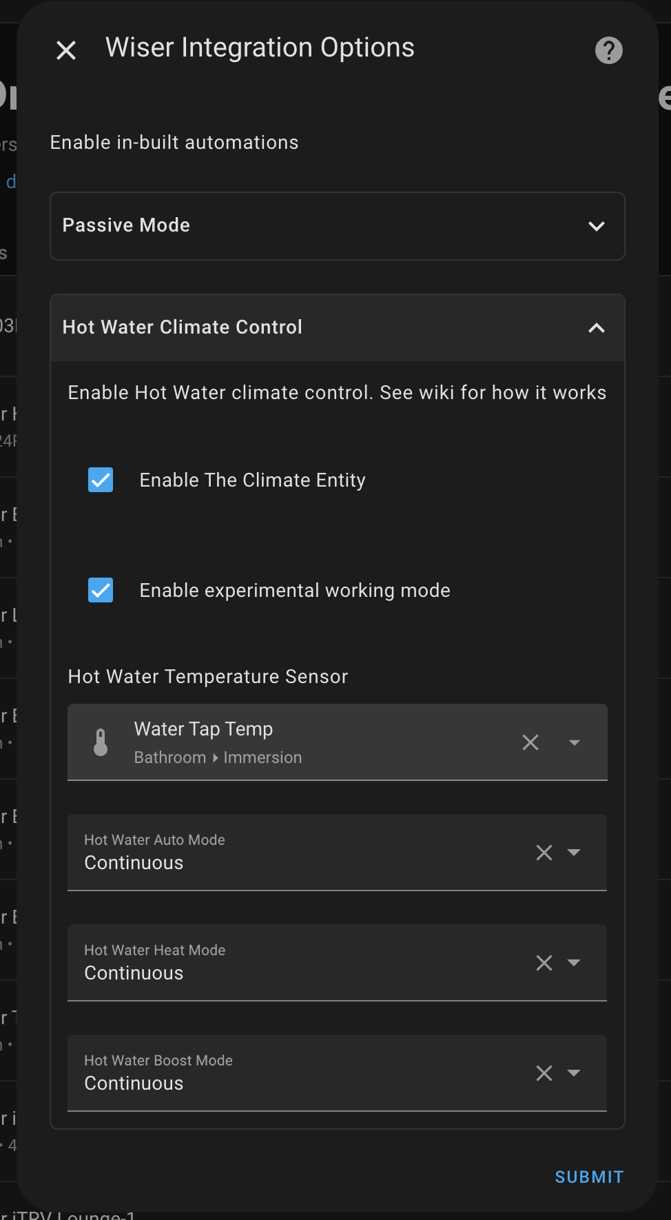

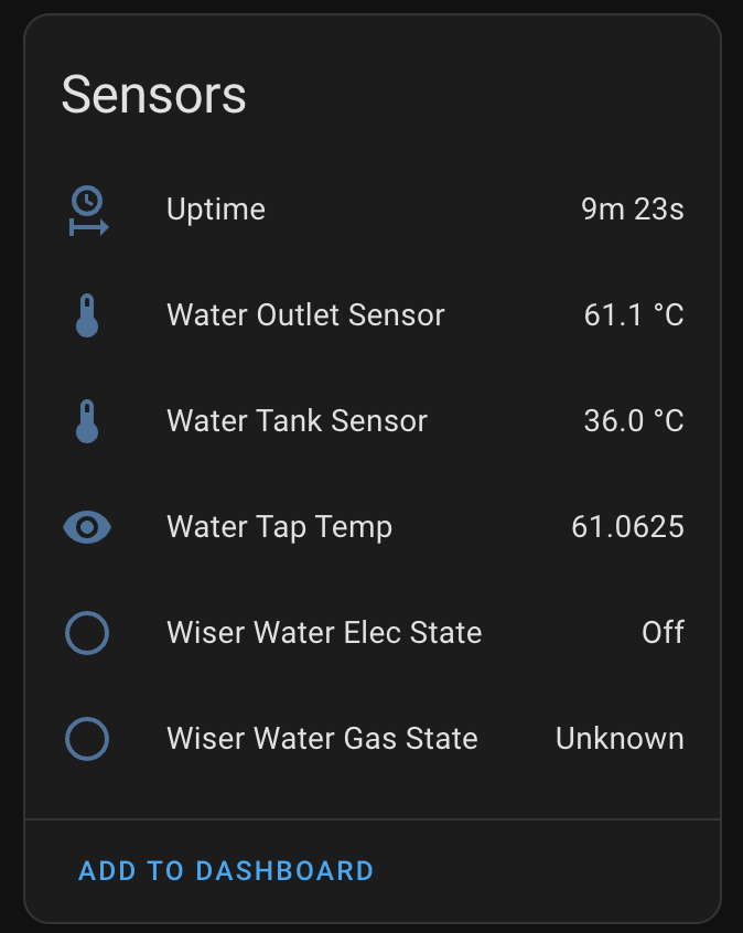

It works well, but in the Hot Water Wiser integration, I am only able to select the Tank sensor or the Outlet Sensor and not the Effective Temperature.
The sensor is not set to internal in ESPHOME and appears correctly in the integration and is also used by my Immersion Climate, but I cannot select it in the wiser water sensor.
Is this because the selection is filtered and excludes template type sensors ?
If so could it be changed ?
It needs to have a device class of temperature, so just add that to your template sensor.
Opps, missed that, thanks so much, yes all good now.

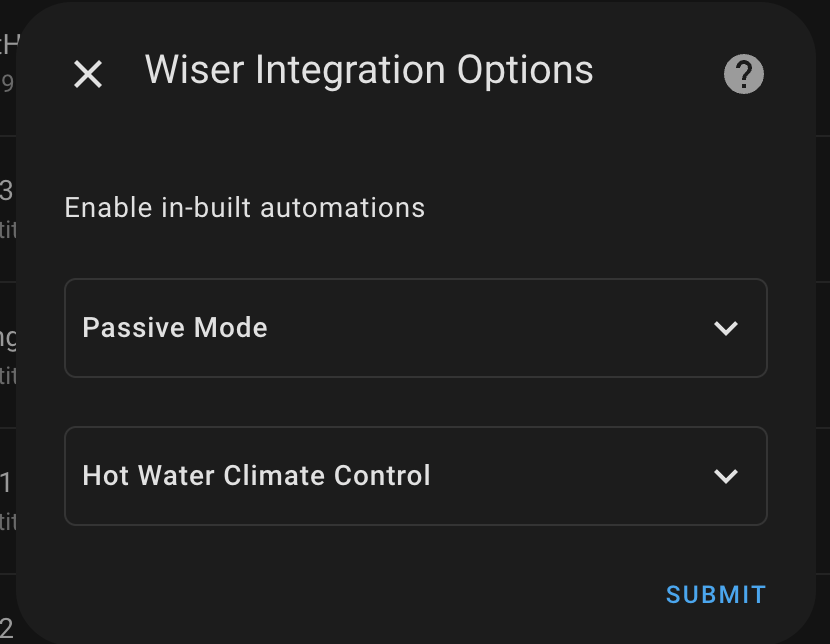

Can you please explain “in the Hot Water Wiser integration, I am only able to select the Tank sensor or the Outlet Sensor and not the Effective Temperature”.
I thought that the Wiser Integration only showed Wiser entities.
I also have Esphome temperature sensors on my hot water tank that I could use to control the Wiser Immersion switch module via automations. Doing it that way I wouldn’t have to add them to the Wiser Integration, just use them to turn the module on and off like any other device. At the moment I just have it scheduled in the Wiser app and haven’t had time to play around with using the temperature sensors to control it.
If there is a way to add them to the Wiser Integration I cannot find it. Or am I misunderstanding your question?
see these screenshots for thw wiser config:
Thanks for the information.
Well that was obvious, don’t know how I missed it. NOT!
I’ve been using Wiser and it’s integration for years. The integration is the main reason I decided to use Wiser. I’ve read about Passive Mode but didn’t have any use for it, so never tried to look for it’s settings and see what was available, and I would never have thought to look there for Hot Water settings!
When I get time I’ll have to explore the options to see if I can make use of any of them.
Thanks for taking the time to reply with the screenshots.

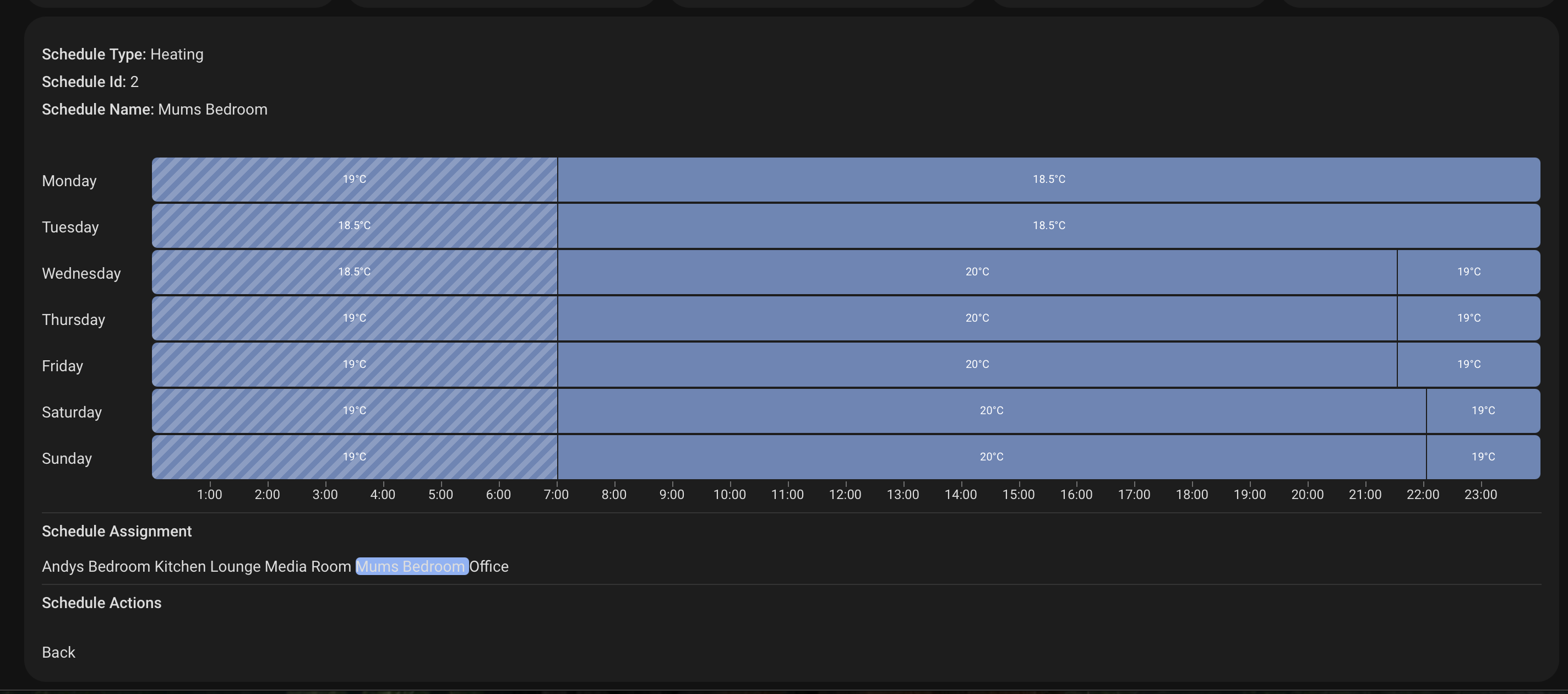

is the Wiser Schedule card broken ?, all I get now is this:
can’t seem to edit the schedules anymore, anyone else experiencing this issue?
edit:
deleted web page cache, all seems ok now.

This keeps happening, I loose the ability to edit schedules, is this happening to anyone else?
It happens on web view or iOS / macOS apps.

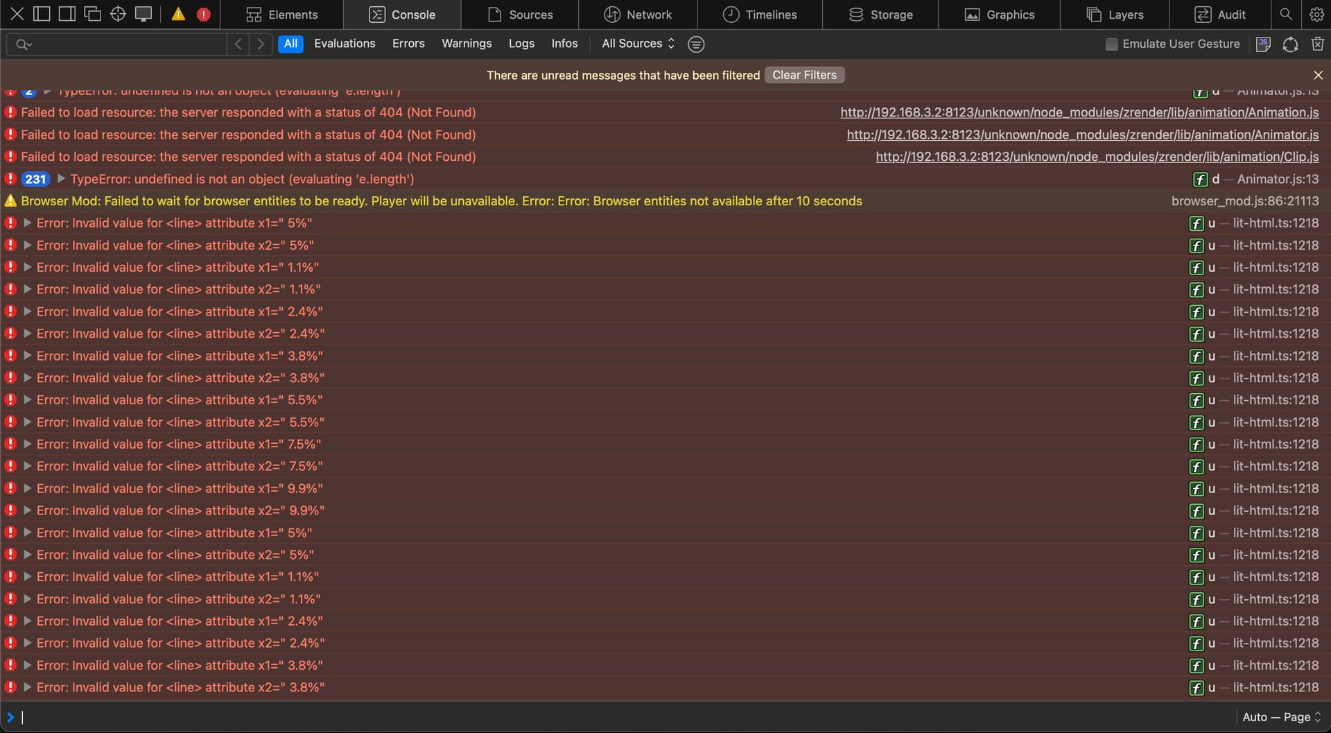

I would look in the browser console (F12 dev tools) for any errors. It could be a conflicting plugin.
any help ?
also, if I remove the card from dashboard and re-add it it shows / works fine again for a while.

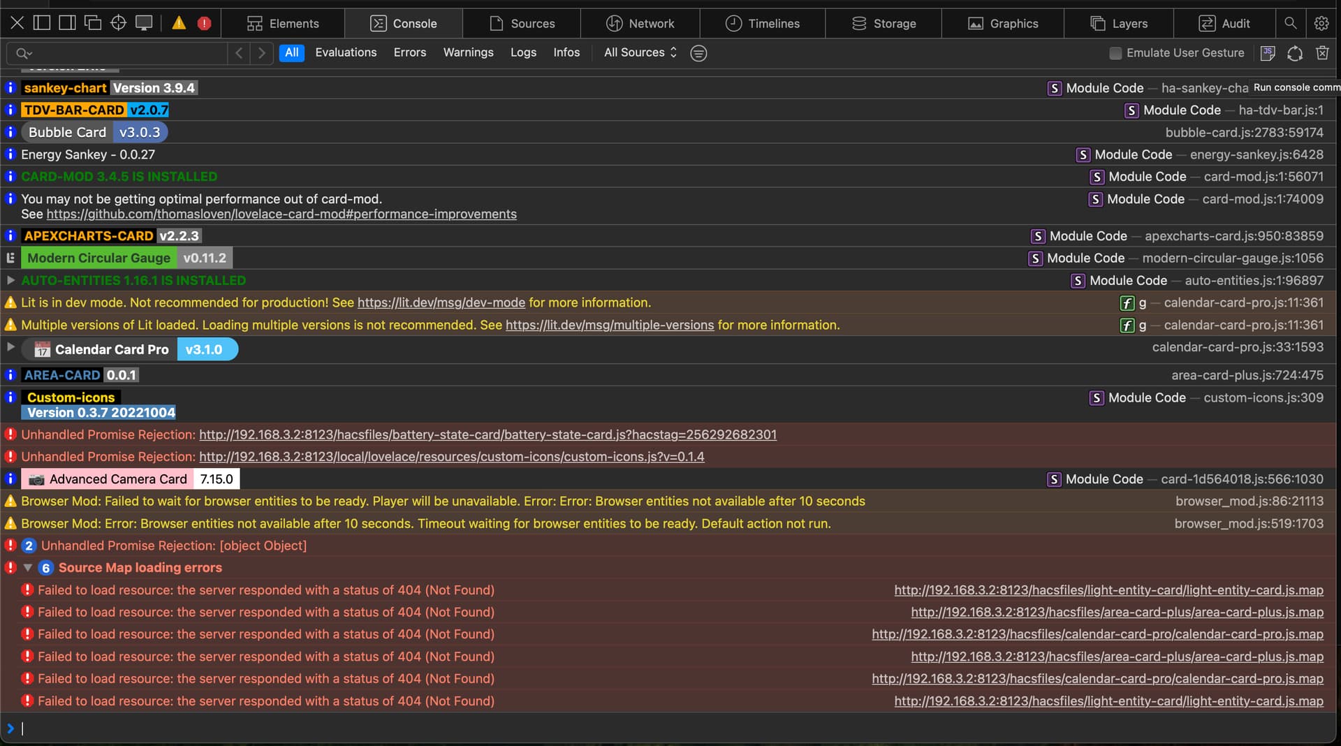

if I remove the card and re-add it it shows ok until I refresh the page, and before I refresh I see these errors , does the card use lit ?
think it down to your card and GitHub - alexpfau/calendar-card-pro: 📅 A sleek and highly customizable calendar card for Home Assistant, designed for performance and a clean, modern look. both seem to use lit-html and both using different versions, causing the issue.
@msp1974 I have tried removing Calendar Card Pro integration, and it made no difference, How can I debug this issue ?
