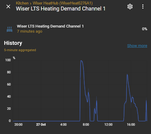

Is anyone else getting permanent 0 values for their sensor.wiser_lts_heating_demand_* sensors? The TRVs seem to be functioning fine.
I noticed a week or so ago that these values are not changing, has an update from Wiser broken their reporting?
I am on Gen 1 of the HubR.
I’m on Gen1 HubR
It looks fine for me
Thanks for confirming this.

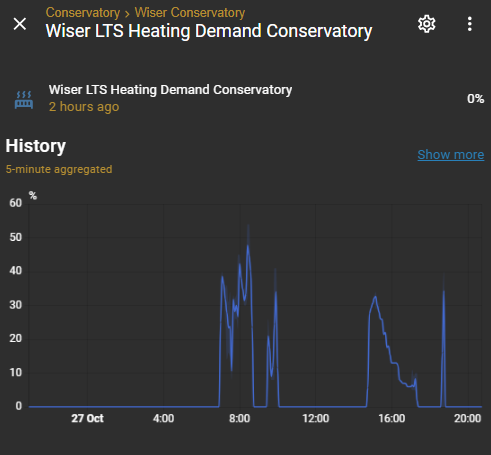

I’ve since found that all ā€œLTSā€ values are 0 or unchanging.
I’m on version 3.4.17. I notice that version 3.3.10 had this change:
and wondered if it had anything to do with it.
I’m also on Drayton wiser integration 3.4.17 and don’t have your issue - so probably not.

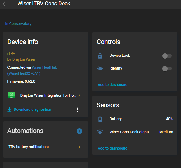

Could you also take a look the heating demand from your TRVs rather than the overall Channel 1? Thanks
I’m confused - I don’t have ā€œheating demandā€ from the iTRV’s
But I have LTS for the rooms they are in.
Here is the Conservatory which has 2 iTRV’s one of which I showed above.
Is this what you meant?
Thankyou, yes, apologies for the confusion - my rooms and TRVs have the same names
