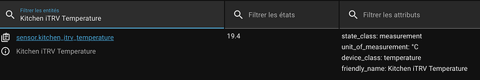

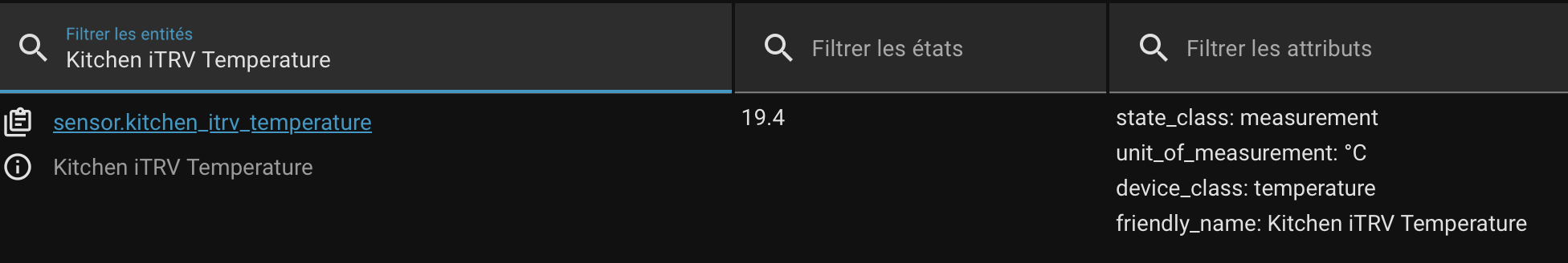

Here is a right definition:
- sensor:
    - name: "Kitchen iTRV Temperature"
      unique_id: "kitchen_itrv_temp"
      unit_of_measurement: "°C"
      device_class: "temperature"
      state_class: "measurement"
      state: >-
        {{ state_attr('sensor.wiser_itrv_kitchen_signal','temperature') }}
  • sensor: you missed the : after sensor
  • replace ’ by "
  • state: add >- and change line with one indentation more
  • {{ state_attr('sensor.wiser_itrv_kitchen_signal’,‘temperature’) }}

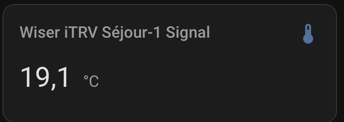

To display the temperature of the iTRV
in code editor:
type: entity
entity: sensor.wiser_itrv_sejour_1_signal
attribute: temperature
unit: °C
icon: mdi:thermometer
grid_options:
columns: full
Possibly being stupid here but a pointer would be appreciated. I added a load of ITRV’s today and was expecting them to pop up in homeassistant but they have not. Do i need to reinstall the wiser custom component for HA? Thanks :slight_smile:
Edit - forced a reload and its picked them up
Thankyou for your help.

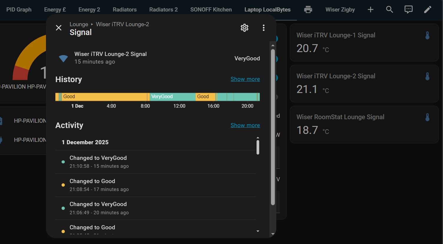

I now have the iTRV temperatures displayed that I was interested in . (Actually for the Lounge, not the kitchen as in the examples).
The code editor was not very helpful in creating them.

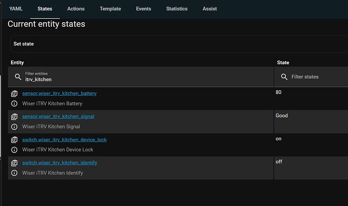

Further confusion…
I assumed in the entities list, the ‘sensor.wiser_itrv_kitchen_signal’ was actually referencing the devices zigbee signal strength.
Indeed, when I click on any of the created temperature displays, the popup shows signal strength data.
So it works, but… how on earth did you suss that out?
The entity display show an attribute of the “sensor.wiser_itrv_room_signal”, when you click on it it call the state of this sensor.
If you want to display the history or the trend of the temperature measured by the iTRV you have to create sensors like I proposed.
For your information, if you need some special information for wiser device have a look to the sensor.wiser_*_signal

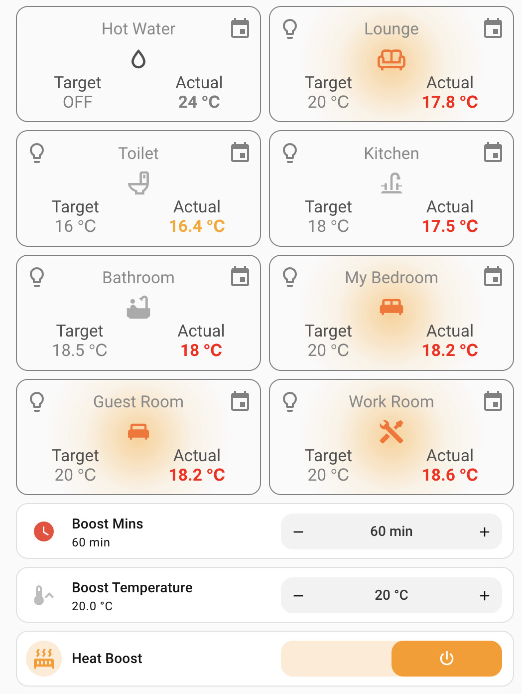

is there any way to boost “all”
service: wiser.boost_heating
  time_period: 60
  temperature: 18
  entity_id: "all"
I know I can just call the boost button but I want to set a bosst time and a target temperature
OK, figured it out:
    # switch.pac_heat_boost_all
    pac_heat_boost_all:
      value_template: "{{ states('sensor.wiser_heating') | lower == 'on' }}"
      turn_on:
          time_period: "{{ states('input_number.pac_wiser_heat_boost_minutes') | int }}"
          temperature: "{{ states('input_number.pac_wiser_heat_boost_target') | float }}"
          entity_id: >
            {{ states.climate
              | selectattr('entity_id', 'match', '^climate\.wiser_')
              | selectattr('attributes', 'contains', 'number_of_trvs')
              | selectattr('attributes.number_of_trvs', '>', 0)
              | map(attribute='entity_id')
              | list }}
      turn_off:
        service: button.press
          entity_id: button.wiser_cancel_all_heating_overrides
      icon_template: >-
        {% if states('sensor.wiser_heating') | lower == 'on' %}
          mdi:radiator
        {% else %}
          mdi:radiator-disabled
        {% endif %}
ok, seems to be some kind of timing issue as not all climates get boosted.
