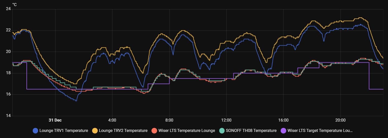

I can understand why Wiser isn’t keen on providing a temperature offset facility for the iTRV. Looking at a typical log of temperatures (attached graph), it isn’t really a constant value.
The blue & yellow traces show two radiator iTRV measurements in one room.
Pink & cyan show the Wiser Roomstat measured temperature and a Sonoff sensor located next to it. They are virtually superimposed on each other.
The violet trace is the Wiser target temperature.
I also did a test with an iTRV physically located next to a Roomstat. (Not fitted to a radiator). Its temperature measurement was identical to the the Roomstat. So they are accurate, but can’t provide a sensible reading when attached to a radiator. Not entirely surprising, when it’s likely changing temperature from say 14 to 60 degrees C.

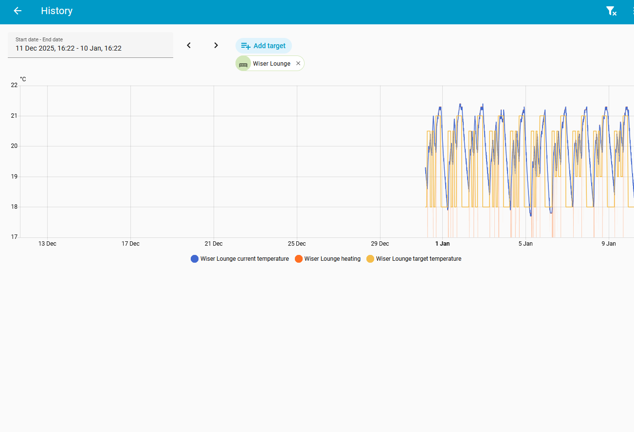

Is it possible to get more than 10 days of history in my history graph…
I have been using my gen2 hub since at least July 2025.

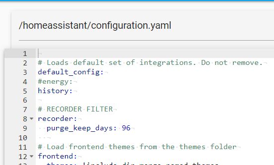

The only way I know is to change (or add) the recorder info in HA configuration.yaml
I changed it to 96 days, as shown here, to give three months worth.

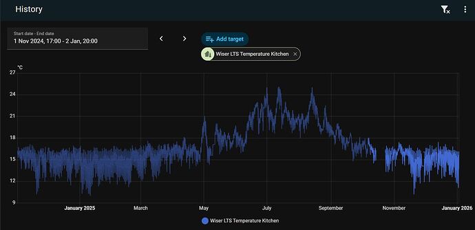

But having said that, if I select over 12 months in the history function, it actually does display at least 12 months…?
I’ve no idea why.
I have LTS (Long Term Statistics) entities for each Wiser device - I recall having to enable these over a year ago, but I can’t find the interface where this is done.
I also note that HA takes a while to draw the entire history chart when you select a long time period - initially only more recent data is shown, then the older data is drawn in. How long did you wait for the chart to finish rendering?

If your question was for me, then that 12 month wiser trace takes around 7 seconds to ‘think about it’ and about 1s to draw it.
I also have an ESP32, using MCP9600’s measuring 3 temperatures, each on a 10 second update time. Selecting a 12 month period for one of those takes around 15 seconds to ‘think about it’, then <1s to draw. They don’t have ‘LTS’ as part of their name, but I don’t know if that is significant.
Downloading data from these show the samples are recorded every 3 minutes, within the 3 months period. Data anything older than 3 months is recorded one every hour. So 24 samples a day.
A total of around 43000 samples for one temperature, for the 12 months…

I can see room temperature history and heating demand history over the last 110 days separately on their respective graphs but when combined with the target temperature I only have 10 days of history.

I’ve just tried the history for my ‘lounge target’ and ‘actual’ and the results are similar to the info I posted before. I get up to 3 months of detailed history. Anything older is on an hourly sample.
