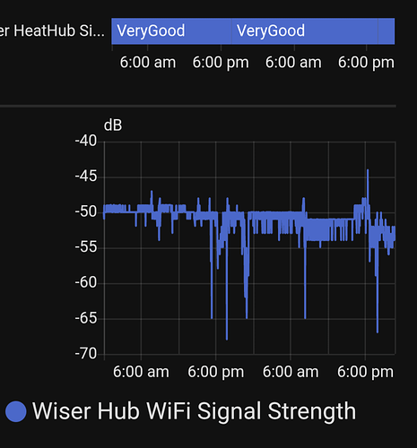

In my opinion, the text descriptions in the Hub Signal strength just aren’t sufficient when you are experiencing problems.
Compare my wifi signal strength stats (using the template entity) with the text version over the same period.
“Very good” hides a lot of variation.
My recommendation is to verify if the disconnects correspond with moments of low signal strength. If they do, try figuring out if there is a removable cause for the signal strength dropping.
