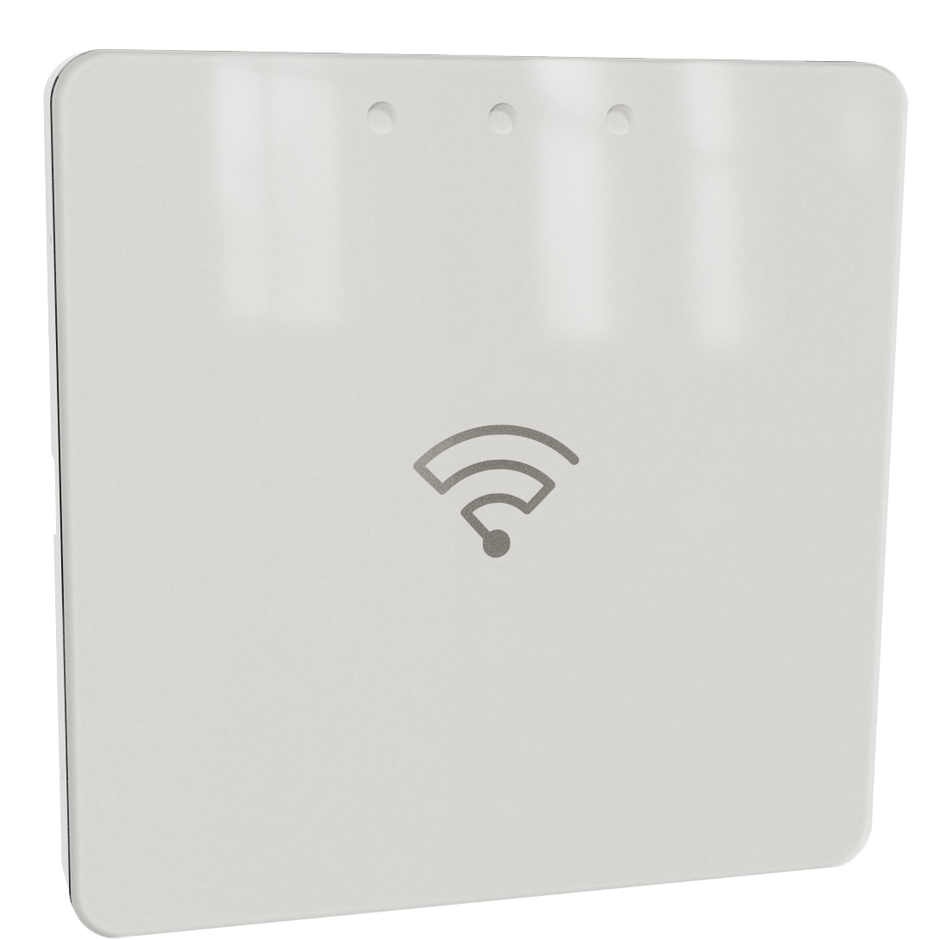

Buying Schneider electric wiser exxact room thermostats. I know that I can integrate them to hass with any zigbee dongle but I’d rather buy a Wiser hub. If I sell my apartment future residents can use “cloud” properties if I leave the hub behind. I read from wiki that this hass integration supports some European wiser hubs but I couldn’t find information which ones. Anyone has experience of this hub:
It’s gen1 CCT501901. And if its supported are there any specific reasons to buy later gen models (which are bit more expensive)?
I could on the other hand just get a zigbee dongle… but with wiser hub there’s also an advantage that you’re capable of setting minimun guard temperature and calibrate also room temperature sensor? So any experiences / thoughts that could help me to decide.

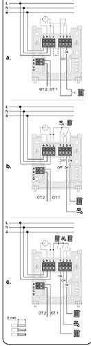

OK… further info. It appears that the “one-channel hubs” (such as CCTRF6311G2) can only control one circuit (even if the connector layout is the same)? Or does the heater “smartly” figure out which source to trigger (I doubt)?
Additional image from the guide:
If you get the single channel option for a combi boiler it will just tell the boiler when to turn on the heating. Combi boilers heat the water on demand without the Wiser systems involvement.
Two channel options are for systems with a hot water tank in addition to heating.
Three channel systems are for systems with hot water and two separate heating areas e.g. upstairs and downstairs which can be heated on different schedules.
It may be possible to hack different use cases with a specific device but probably not wise if you dont know much about wet heating systems, and value your home.
Personally I would buy the appropriate Wiser HeatHub based on the type of heating system you already have or plan on getting - keep it simple as having a warm house on winter is important. Gen1 is fine in my experience if you can still buy it.
Thanks a lot @dunxd for the response - and indeed, messing with the heater is not a good idea. I can’t seem to find the Gen2 3-channel anywhere (only visible on the SE UK page, and no place to buy it), as that’d meet my needs fully (two heating circuits with different parameters, one hot water).
