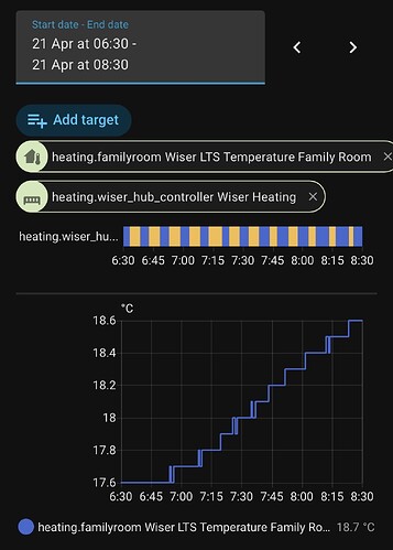

Hi, I doubt this is anything to do with the HA integration but I wanted to check if this is normal behaviour… I’ve just installed the Wiser thermostat and for some reason it seems to ‘short cycle’ my combi boiler, so it is turning on/off every 3-5 mins while the room is not yet up to temperature.
So in this example the room was at 17.6 and set to heat to 18.5 between 6:30-8:30. For some reason the heating kept turning off even though the target had not yet been reached:
That is the expected behaviour as the room approaches the setpoint. The Wiser system slowly nudges the temperature up by cycling the boiler. The number of cycles per hour for a gas boiler is set at 6, so you could have a 5 on followed by 5 off. Whilst a bit counter intuitative you can reduce the number of cycles by telling the Wiser system you have an oil boiler as this uses 3 cycles per hour.
The Wiser system works on the basis that there is a certain lag between the boiler going off and the temperature achieved as water continues to flow through the radiators for a few minutes whilst the pump continues to run.
Thanks for explaining. I understand the logic, but it still doesn’t seem right to switch it off after just 5 minutes when almost 1 degree below the target (bear in mind it took 2 hours to actually reach the target this way). The radiators barely warm up in that time! I’ve seen it switch off after just 2 minutes even.
Does the system learn at all and improve how it manages this over time?

My view may be a little simplistic on how this actually works under the covers. When the system starts up in the morning and the actual temp is say 3c from the setpoint the boiler will be on 100% of the time, once it gets to about 1c below the setpoint the boiler will start to cycle and the demand percentage drops to 90, 80, 60, etc.
In part I suspect this is because there is a certain latent heat in the radiators and even after the boiler cuts out and subsequently the pump stops the room temp will continue to rise slightly. The system is trying not to overshoot the setpoint.
So with the default gas boiler of 6 on/off cycles per hour each 10 minute period could have a decreasing “on” period as the temp approachs the setpoint. By changing to “oil” you probably have the same total “on” or “off” minutes per hour but they are in larger chunks. So instead of being “on” for 5 minutes it would be 10 minutes but a larger gap until the next “on” period.
This is a good explanation. Latent heat in the system is also key.
