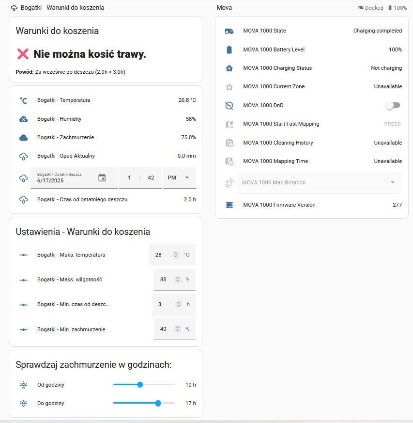

On start, I’d like to say, your integration works with my Mova 1000 and can be very useful for me.
For the moment I can see the status, battery level, charging status and firmware. There is no Current Zone, and the rest of option are greyed out.
Are you planning to make any option to control the mower (Dock, Pause, Resume etc )?
I see potential in having the HA to control if its mowing according to current weather to mowe only in conditions that are healthy for the grass.
I’ve build conditions that are checking if mowing should happen - humidity (to wet), too early after rain (still wet), temperature to high,not enough clouds (too much sun) — this finally gives a status “Can work (true) / No Mowing (false)” and I’d love to integrate this with the mower now - see attachment.

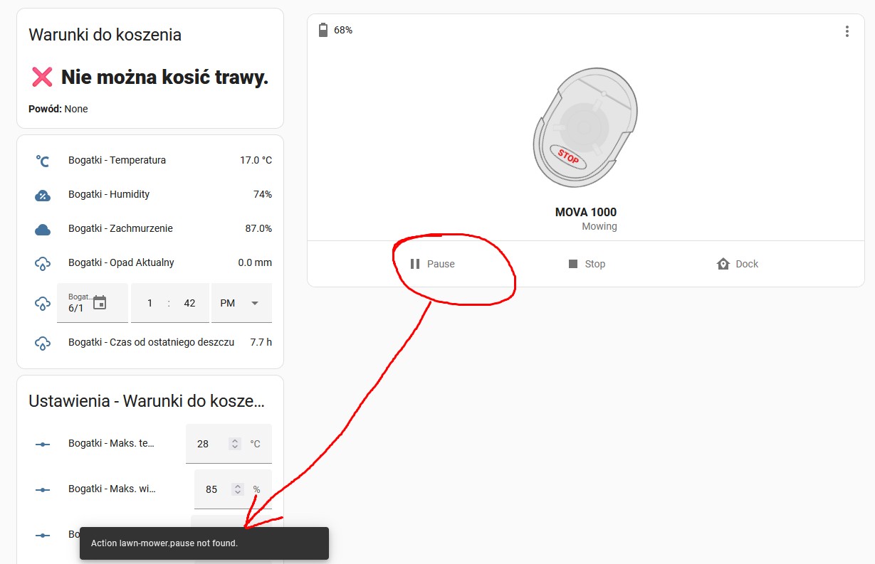

It would by obsolutely great to have the Pause, Stop, Dock function working.
Unfortunately the lawn_mower actions are no valid:

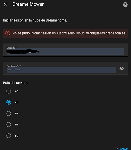

A couple of days ago, I thought yes, that you were a beginner on these issues. Since yesterday, I tried to install integration and I saw the screen to log in, I think we are already two who have a short circuit between the accounts of Xiaomi and Dreame.
Error screen attached.
