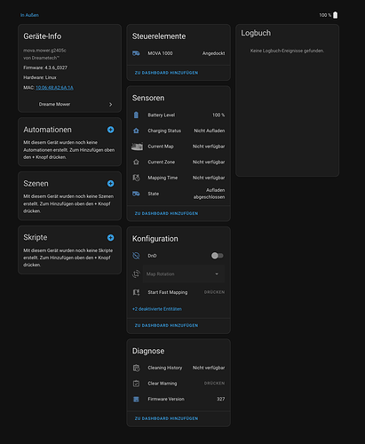

Moin together! I took some time to rewrite the integration from ground up. Check out the pre-release version 0.1.1 if you like.
You can now pick the “modern” implementation variant when re-creating the device in the integration. The main feature of potential interest is the live / last mowing session map. File bugs if you run into regression.

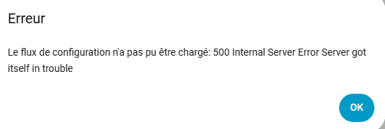

Hello Anton,
the integration doesn’t work, I have this error message :
Thanks.
I can send you HA logs if needed.
I have the same error and have created a Github issue with logs here.
