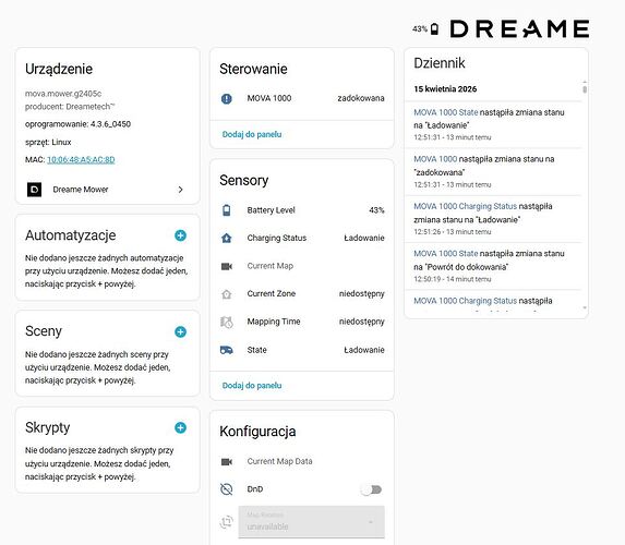

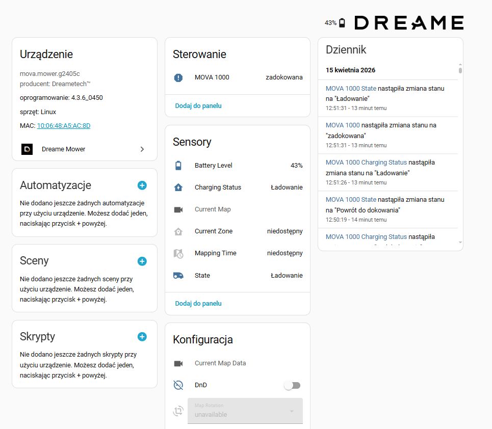

I managed to add my MOVA 100 robotic lawnmower, but most of the entities aren’t working. Any ideas?
Hi daxh64, i have the viax300 an i integrated it with this repo and custom integration: https://github.com/antondaubert/dreame-mower it`s better updatet and always newer. It works out of the box!

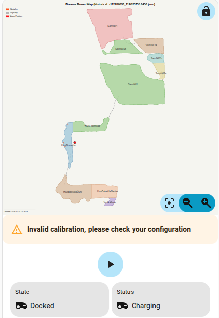

Has anyone integrated the map in a good way, f. ex. using custom:xiaomi-vacuum-map-card or any other map card? If so, it'd be great if an example could be shared. Currently I'm using the above, but just for display, and have not managed to map the buttons/actions or statuses..
Also, is there a list of actions for the robot? I tried the following, but "start" does not seem to exist, I get the error "Action lawn_mower.start does not exist"..
    tap_action:
      action: call-service
      service: lawn_mower.start
      service_data:
        entity_id: lawn_mower.cutty
To (partially) answer my own question, the available actions can be found under Dev Tools -> Actions, and what's currently available is:
lawn_mover.start_moving, .pause and .dock.
I've modified the Xiaomi-vacuum-map-card and got it to work decently (though it displays "Invalid calibration, please check your configuration") with updating map and action buttons which works as intended (start / pause / return to base):

Tried adding my Mova 600, but there is no entities generated. Any idea why?
EDIT: I waited for a bit and now all the sensors are there :grinning_face_with_smiling_eyes:
