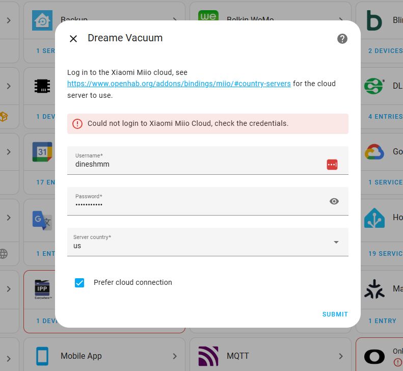

I’ve been having a heck of a time trying to integrate my new Dreame X40 Ultra robot vacuum into HA. I’ve created an account via the app, (got my ID, email address, password, etc all registered. Then downloaded the HACS Dreame integration. I’ve been looking at this post (Custom Component: Dreame Vacuum) and (GitHub - Tasshack/dreame-vacuum: Home Assistant integration for Dreame robot vacuums with map support), and for the life of me can’t figure out how to get this into HA. Some directions say to create an account with Xiamo, but I’m confused on how to bring my device into that - I’ve created that account but nothing… I always get an error message when trying to put in my login info:
Does anyone else have this model, or know how to integrate this into HA? Any help would be appreciated!!
I’m stumped on how to get this into HA

You need to install the latest Beta to get the Dreamehome account support.

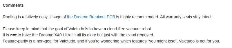

If you install Valetudo you will loose some of the important features of device so that you can buy L10s instead.
Here is a snippet from Valetudo support page.
Thank you!! This is what fixed the issue for me. I am seeing everything now. Much appreciated!!
Do you know if these features are documented somewhere? I haven’t been able to find it.
There are still benefits to the higher end robovacs which I guess should not be affected (extendable arm, mop autoclean etc). I’m not so concerned if I don’t have camera access or the like with Valetudo, but if it cleans worse then it might not be an option.

Yes, the beta version has fixed the issue. Thanks @tasshack

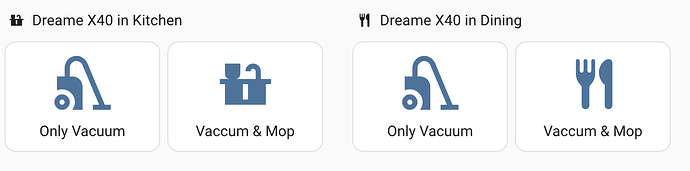

@svalle This feature hasn’t been implemented in HACS yet, but there are workarounds to achieve the same result.
One approach that worked for me is to create a shortcut in the Dreame app that only vacuums a specific room.
You can then access that shortcut in Home Assistant and create a button to trigger it directly.
I hope this helps!
If anyone knows a better approach, I’d love to hear about it.
I just got a X40 Ultra too… curious so did you install the beta version in order to just get pass the “xiaomi” login? It’d be nice if the plugin didn’t call it Xiami, or maybe refer to it as Dreame / Xiaomi to avoid the confusion (at least for me)…
The Beta version allows you to log in directly to Dreame using your Dreame account credentials. No Xiaomi login required.
