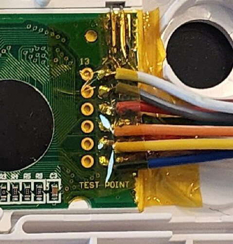

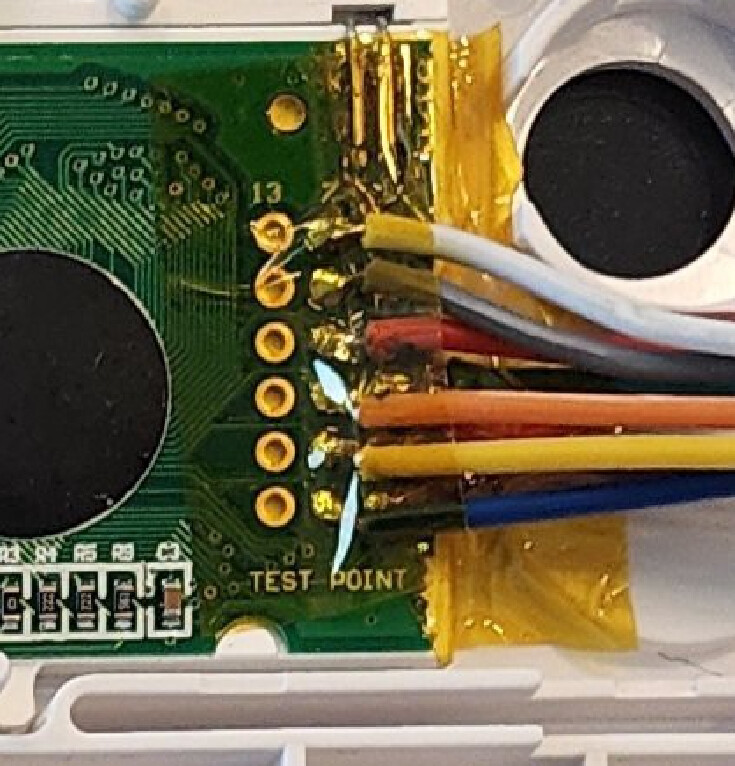

good morning Valdez, I see that you have used the first 12 test point pins. But I don’t see anywhere in the post that says exactly which test point pin is such a thing. I think the necessary ones to know are:
RS
RW
E
D4
D5
D6
D7
and which LCD pin test should be linked.
Thank you!
