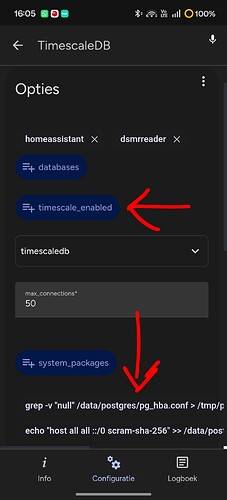

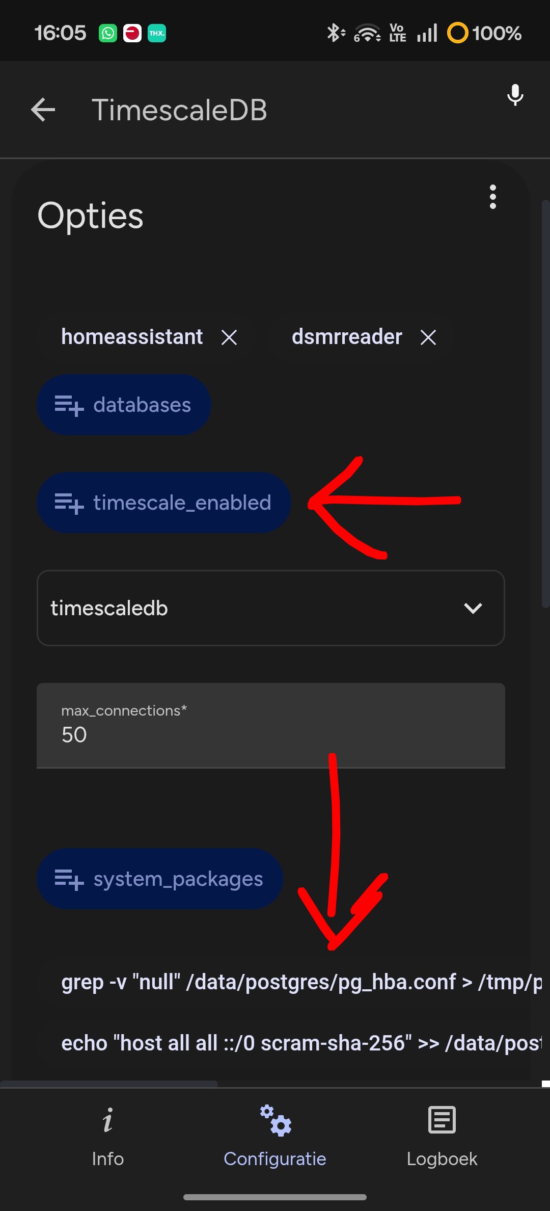

check if its still there in de config. Because if you copy the whole piece, it won’t accept the save because there is standard all ready a rule “init_commands” in the timescale config (edit with Yaml)
I got it working by adapting timescale:
  1. Removing homeassistant under ‘timescale_enabled’
  2. Adding the init_commands
Thanks that helped, i got it upgraded now to 6.0.2
