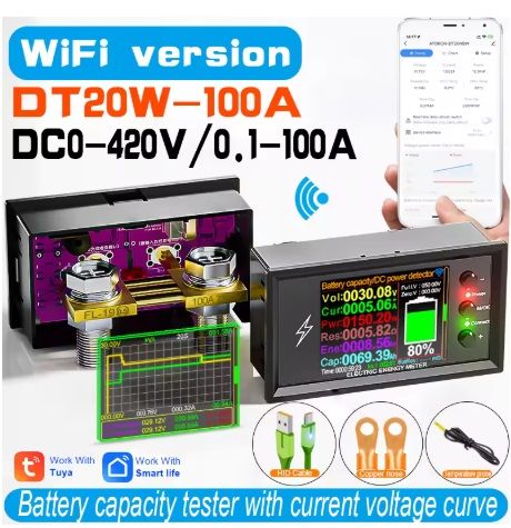

DT20HBW Smart Battery Monitor Integration
The DT20HBW is a Smart Battery Monitor by Atorch that also supports a relay switch add-on module. Currently, it can only be controlled through the Tuya mobile app, and it is not supported by official Tuya or LocalTuya integrations.
Therefore, I have developed a custom integration to enable support for the DT20HBW in Home Assistant, allowing for automation and other functionalities. This integration is implemented with TinyTuya, which enables local control without relying on the cloud.
My primary use for the DT20HBW is to control the LiFePO4 battery connected to my EcoFlow Delta 2 Max via its solar PV input. With this integration, I can set up automations such as automatically turning on the relay switch when the EcoFlow Delta 2 Max’s charge drops to a certain level, and turning off the relay switch when the LiFePO4 battery voltage drops to a certain level.

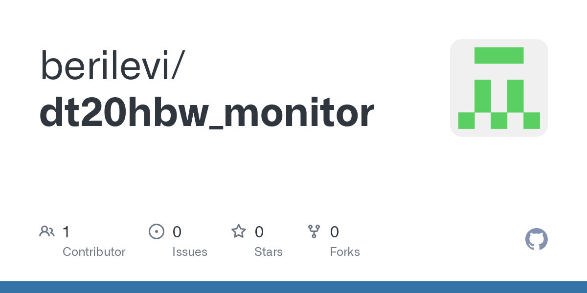

I would like to submit this integration to HACS and am currently exploring the next steps in the process.
Here is the repository link:
