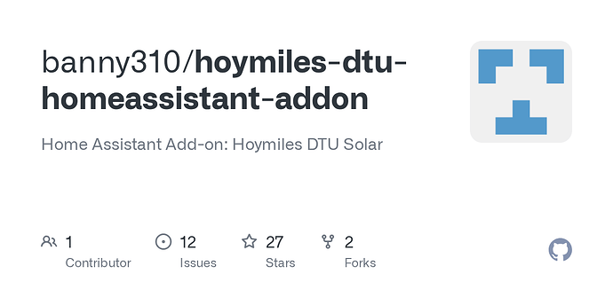

  1. Install the Hoymiles DTU Solar: Home Assistant Add-on. There are two, one stable and one unstable.
I installed both.
Installing the Hoymiles DTU Solar: Home Assistant Add-on
Follow the step-by-step instructions in the documentation on how to install it or use the Android app Fing. After installing, go to settings >

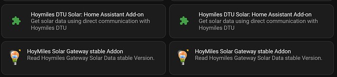

Repeat the steps installing the same add-on because one version is stable and the other is not, and I don’t know which one is working because one programmer stopped and another continued. It won’t cause a conflict, it will just be another useless addition to your HA. It’s just that one works and the other doesn’t. >
Repeat the steps above in settings and just copy and paste the configuration.yml file.
Now let’s move on to the second program.
I installed both as well because it’s the same thing with the first one, one is stable and the other doesn’t work. >

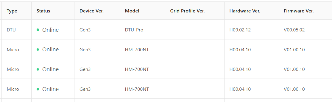

Here is the hardware for my setup.
I was unable to login via IP:Port, due to that I had to go down the rabbit hole of learning MODBUS/TCP and that was a pain. Now I understand it but still not a pro by no means.
