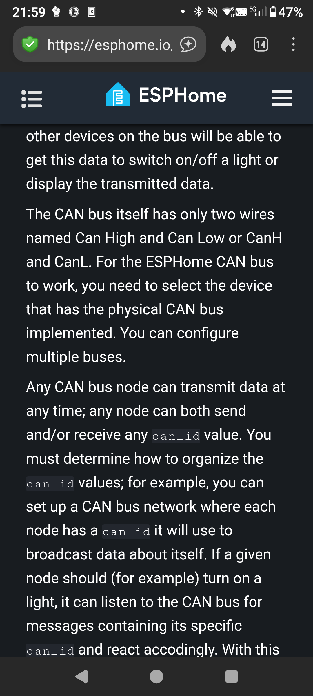

Multiple buses supported :sunglasses:

Yes I’ve used multiple busses in the past as I stated with the TJA1050 and the MCP2515 but I was sepcifically wondering about using two TJA1050 with the ESP32-C6 since that supported 2.
I answered my own question though, ended up buying them to test and can confirm, you can use two TJA1050 with the ESP32-C6 in case anyone else runs into a use case for them,
