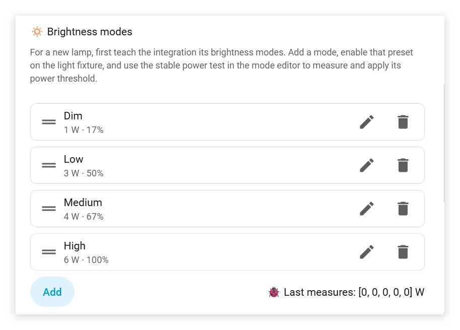

While traveling through :denmark: Denmark, I was given a tip to try a special kind of hunting โ€” looking for interesting things at local flea markets. At one of them, I found a curious LED floor lamp with several brightness modes. I loaded it into the trunk and, after getting back home a week later, started wondering: should I replace its electronics, or solve the problem with a hack? And I do love hacks =)
For the next week, the lamp basically became a lab bench. I ran it through every mode, measured current and power, caught spikes, edge cases, and dozens of on/off and recovery scenarios. In the end, the system became self-learning, and the integration accumulated a lot of carefully polished details โ€” from stable state detection and physical-button handling to recovery logic, delays, learning, and UI behavior. At this point, it is no longer an experimental hack, but a pretty polished solution for everyday use.
:sparkles: Features and highlights:
  • Creates a native Home Assistant `light` entity compatible with automations, scripts, and the standard HA interface;
  • Turns the lamp on correctly regardless of how it was switched off โ€” through the smart plug or with the lampโ€™s own physical button;
  • Automatically detects the current mode from the actually measured stable power consumption;
  • Learns during setup: the user switches through the lampโ€™s modes, while the integration measures and stores the power consumption of each one;
  • Filters unstable readings and borderline values so the detected mode does not โ€œjumpโ€;
  • Supports any number of modes;

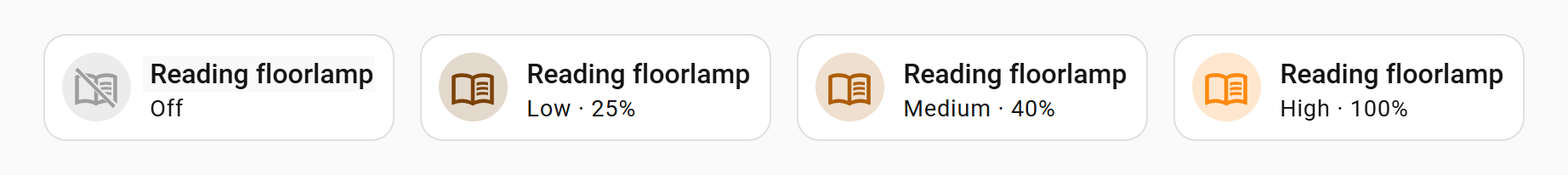

  • The card is built on top of the standard Home Assistant Tile Card and visually reflects the current brightness;
  • Lets you configure the off-state power threshold and the power-cycle delay;
  • The interface is localized for 64 Home Assistant locales.

Feature Template Light Smart Plug Multi-Level Light
Create a light entity on top of other entities :white_check_mark: :white_check_mark:
Determine on/off state from a power sensor :white_check_mark: With a template :white_check_mark: Built in
Convert measured power into a brightness value :white_check_mark: With a template :white_check_mark: Built in
Support multiple discrete physical brightness modes :gear: Must be implemented manually :white_check_mark: Built in
Calibrate modes from actual power measurements :cross_mark: No dedicated workflow :white_check_mark: Directly from the UI
Detect the current physical mode from power consumption :gear: Must be implemented manually :white_check_mark: Built in
Filter unstable/noisy power readings before changing mode :gear: Requires additional logic/helpers :white_check_mark: Built in
Power-cycle the plug when the plug is on but the lamp itself is off :gear: Can be implemented with a script :white_check_mark: Built in and configurable
Automatically limit power-sensor selection to sensors belonging to the selected plug :cross_mark: :white_check_mark:
Configure and edit modes through the Home Assistant UI :cross_mark: :white_check_mark:
Configure filtering and power-cycle parameters through the UI :cross_mark: :white_check_mark:
Dedicated Lovelace card showing detected mode and calculated brightness :cross_mark: :white_check_mark:
Requires the user to design templates/scripts/helpers :white_check_mark: For this use case :cross_mark:
