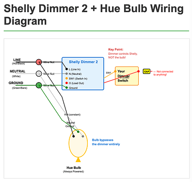

So a potential hacky solution is to split the wiring in front of the switch, run one line to the Shelly Dimmer and that to the dimmer switch, and the other split as constant power to the lights. Here’s a diagram:
I’d love any and all critiques of this solution or pointers to products that would get me where I’m trying to go. The critical bit is just using my dumb rotary dimmer switch.
Any thoughts? Thanks!
Edit: Ignore “SW1” label, meant to be Shelly Dimmer Gen 4.

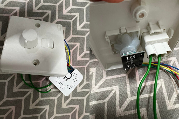

I did a similar thing but with a rotary encoder.
Basically I just removed the dimmer board, and reuse the dimmer button and switch plate
That’s not gonna work in your diagram because SW1 is meant for momentary switch
RIGHT that’s a label I meant to change. Should be the Shelly Dimmer Gen 4 (think it’s S4DM).
