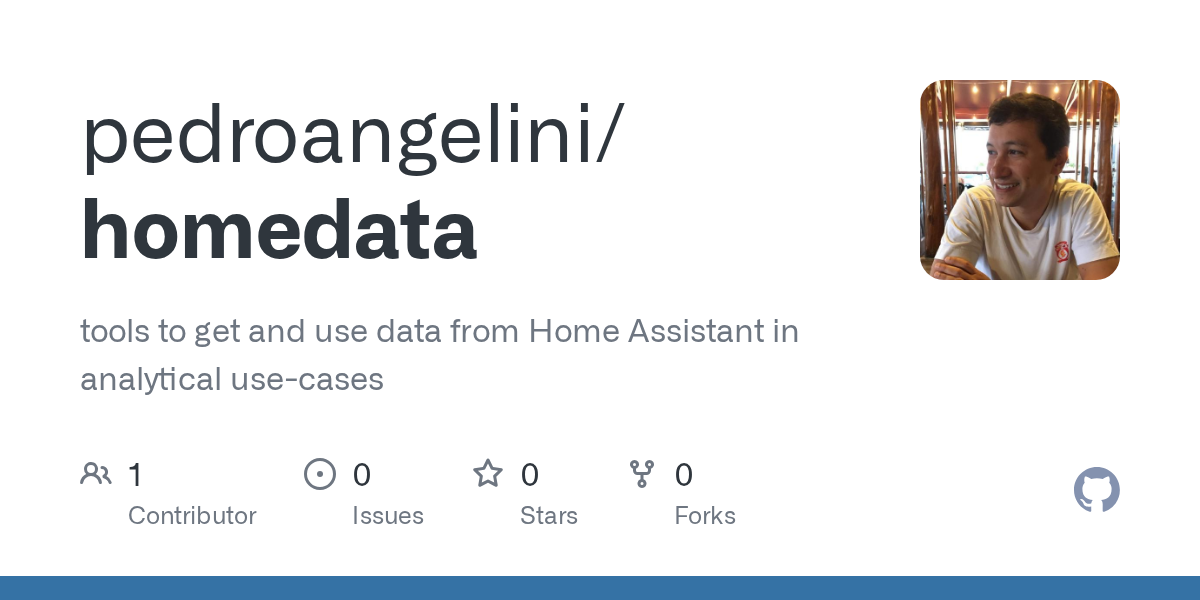

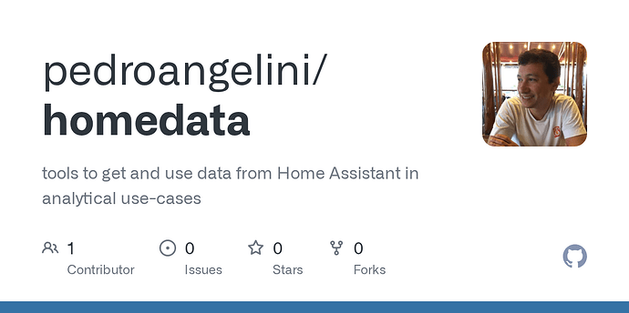

So I built this small script and systemd unit/timer, and will start scraping my HA db every hour into a DuckDB file in my host server. I simply copy the HD SQLite DB to the host via ssh to avoid impacting the HA instance, then do light processing to save the data in a easy-to-use format
It’s very simple, and doesn’t yet allow for filtering entities, nor does it automatically manage data retention (I’ll have to trim it from time to time), but I think it will do the trick for a few months.
Does anyone see any obvious downside or issue with this approach?
Any ideas on what fun things you could do with this type of rich and granular data collected over a few months?
