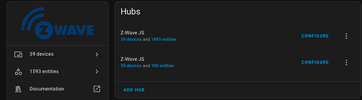

After 2025.2, I had a second z-wave integration popup as detected in my HA install pointing to my existing z-wave add-on, and I (foolishly?) clicked add. It seemed to not break anything, so I just kept on keeping on. One is using a local domain and one is the ip of the Z-Wave JS Add on:
Screenshots
They do not have the same number of entities though, so I’m quite hesitant on how to address this:

What is the safe way out of this? I disabled one of the two integrations yesterday and a bunch of my z-wave nodes went unavailable, so I paused until I had time to ask this question. Thanks!

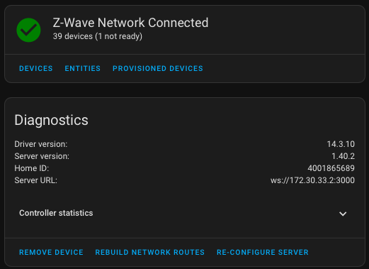

I’m not sure I understand what you’re saying. I have one Z-Wave JS UI add-on, but two integrations now. One pointing to a0d7b954-zwavejs2mqtt and one to the internal ip of 172.30.33.2.
If I disable a0d7b954-zwavejs2mqtt, my z-wave devices go to unavailable. If I re-enable it my devices come back.
If I disable the 172.30.33.2, my z-wave devices go to unavailable. If I re-enable it my devices come back.
But having two is clearly problematic. How can I get rid of one if simply disabling one makes all of my z-wave devices drop off?
EDIT: Maybe I wasn’t giving it enough time. I disabled one, reloaded it, restarted the Z-Wave JS Add-on and it seems all but one battery device are fine. Oddly though, that device shows fine (online) in the actual add-on.
