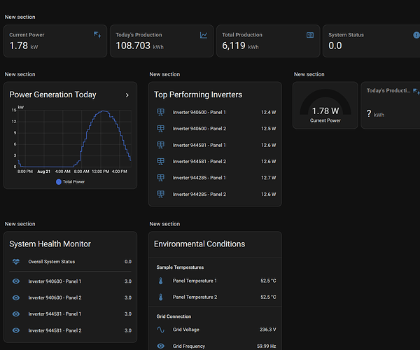

Claude and I were able to get the data into HA but Duracell keeps autologging me out of the website every 24hrs on the dot.
Since Duracell Power Center has a web portal at pv.duracellpowercenter.app, you might be able to:
  1. Inspect the web app’s API calls using browser developer tools
  2. Create RESTful sensors in Home Assistant that call the same endpoints
  3. Set up authentication (likely token-based) to access your data
You’d need to configure sensors like this in your configuration.yaml:
yaml
sensor:
  - platform: rest
    resource: "https://pv.duracellpowercenter.app/api/your-endpoint"
    headers:
      Authorization: "Bearer YOUR_TOKEN"
    name: "Solar Production"
    value_template: "{{ value_json.power }}"
Then I had to put this in my configuration yaml
rest:
rest:
- resource: https://pv.duracellpowercenter.app/platform/api/gateway/pvm-data/data_count_station_real_data
  method: POST
  headers:
    Content-Type: application/json
    Cookie: >-
      duracell_token="insert your cookie token here"
  payload: '{"sid":9188200}'
  scan_interval: 600
  sensor:
    - name: "Duracell Real Power"
      unique_id: duracell_real_power
      value_template: "{{ value_json.data.real_power | float }}"
      unit_of_measurement: "W"
      device_class: power
      state_class: measurement
    - name: "Duracell Output Percent"
      unique_id: duracell_output_percent
      value_template: >
        {% set power = value_json.data.real_power | float %}
        {{ ((power / 20500) * 100) | round(1) }}
      unit_of_measurement: "%"
      icon: mdi:percent
    - name: "Duracell Today's Energy"
      unique_id: duracell_todays_energy
      value_template: >
        {% set val = value_json.data.today_eq | default('0') %}
        {% if val != 'null' and val != '' %}
          {{ (val | float / 1000) | round(2) }}
        {% else %}
          0
        {% endif %}
      unit_of_measurement: "kWh"
      device_class: energy
      state_class: total_increasing
    - name: "Duracell Last Update"
      unique_id: duracell_last_update
      value_template: >
        {{ value_json.data.data_time | default("Unavailable") }}
      icon: mdi:clock-outline
    - name: "Duracell Capacity"
      unique_id: duracell_capacity
      value_template: "{{ value_json.data.capacitor | float }}"
      unit_of_measurement: "kW"
      device_class: power
This works too and talks to the panels

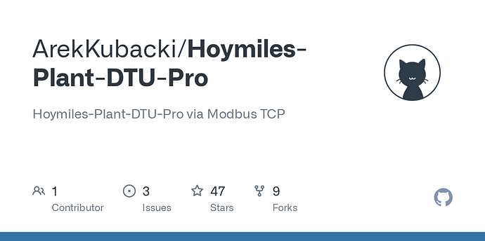

Hi @lampshade29
Sorry to be clear, are you saying the linked code works with Duracell inverters?
Have you tested this, or do you otherwise know that it obeys the same modbus specs?
Thanks
it does work, I was able to and create sensors
update.hoymiles_plant_dtu_pro_update
switch.hoymiles_plant_dtu_pro_pre_release
sensor.hoymiles_pv_pv_power
sensor.hoymiles_pv_today_production
sensor.hoymiles_pv_total_production
sensor.hoymiles_pv_alarm_flag
