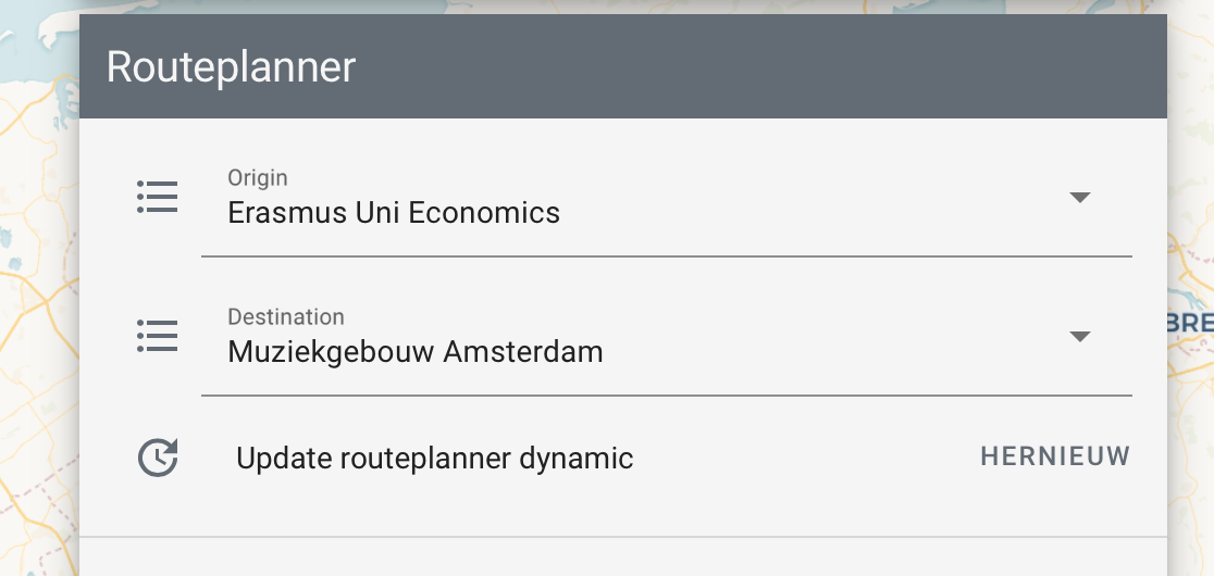

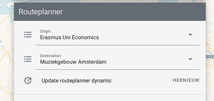

sure, sorry I didnt make that clear.
I simply want to have an origin and destination in dropdown, and then create the travel itinerary/time of several routes I usually take.
So, not requiring the full DB in dropdown :wink: but a few preselected ones would be nice in the UI, and then throw that at the integration,
Like this with eg Waze
