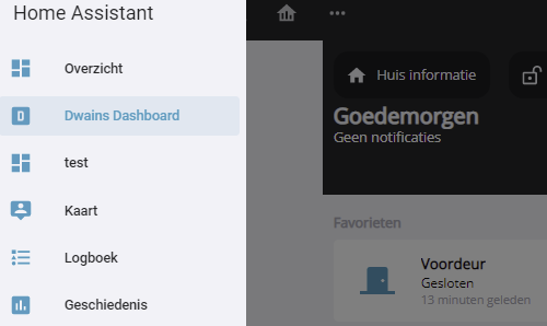

A Lovelace light theme based on Dwains Dashboard
Created by Léon van der Linden
![](upload://aGQCnnDs00dCuPUc5n9bWLr9L7p.png)
