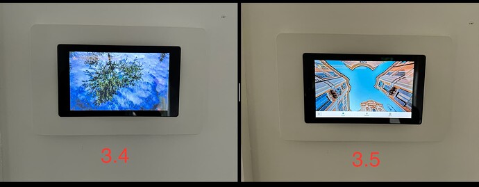

I run WallPanel on my wall mounted tablets. After updating to 3.5.0 my tablets show the the Dwains-Dashboard menu when WallPanel activates. This doesn’t look great and will cause screen burn is there any way to hide the menu? This didn’t happen in 3.4.X. I’d stick with 3.4 but i get the browser error for the UI. Any help appreciated.
