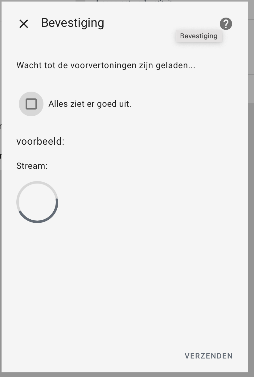

all looking good it says… but never resolves

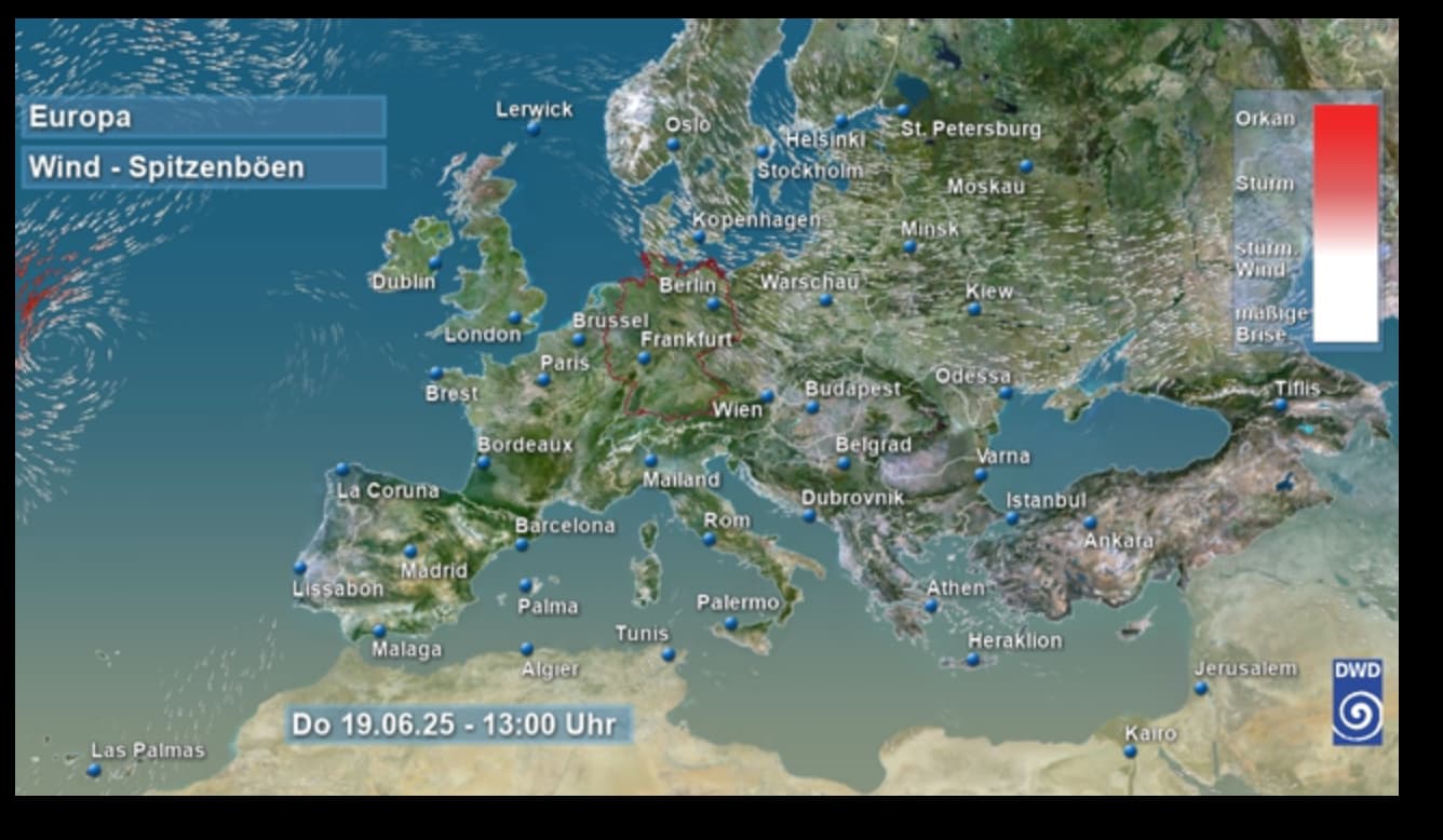

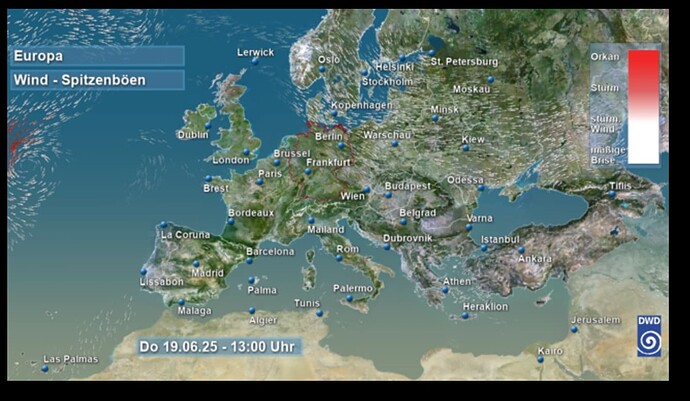

I can use it as picture directly btw:
type: picture
image: https://www.dwd.de/DWD/wetter/wv_allg/europa/film/vhs_Europa_Wind_360.mp4
I get validation that everything looks good, but it doesn’t load.
Same results you are seeing
yeah, and the picture results in:
which is fine of course.

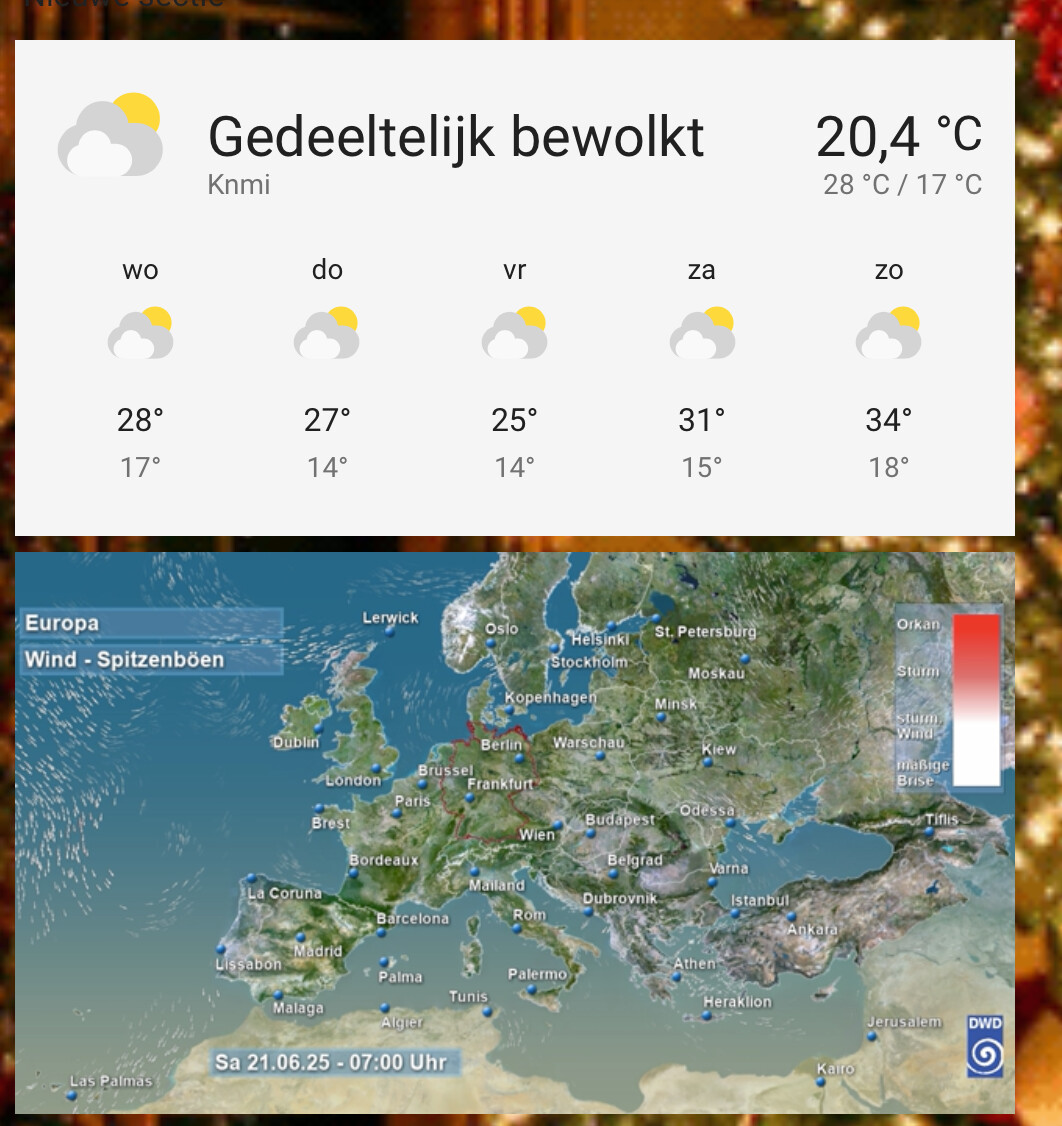

the picture is fine too now :wink:

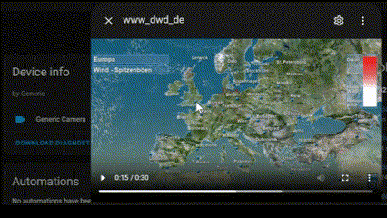

Got it working…somewhat
Not a H.265 issue. Started testing this in my config
stream:
  ll_hls: false
  part_duration: 1
  segment_duration: 10
Stream details
Video: MPEG4 Video (H264) 640x360 25fps 6760kbps [V: h264 high L4.1, yuv420p, 640x360, 6760 kb/s]
It’s an audio and video formatting conflict.

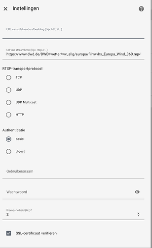

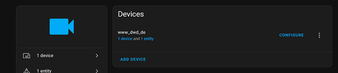

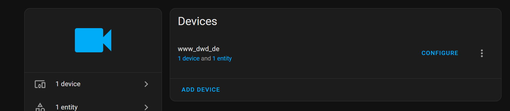

but where? that’s is not in the generic camera UI is it? Seems the old yaml config
No it is. There are some extra options you can configure.
I need to have a better understanding on how HA processes rtsp, webRTC and the audio codecs.
odd, if I click Configure there, those options are not populated at all, all I see is the UI I posted above
Doesn’t seem to be available via the UI

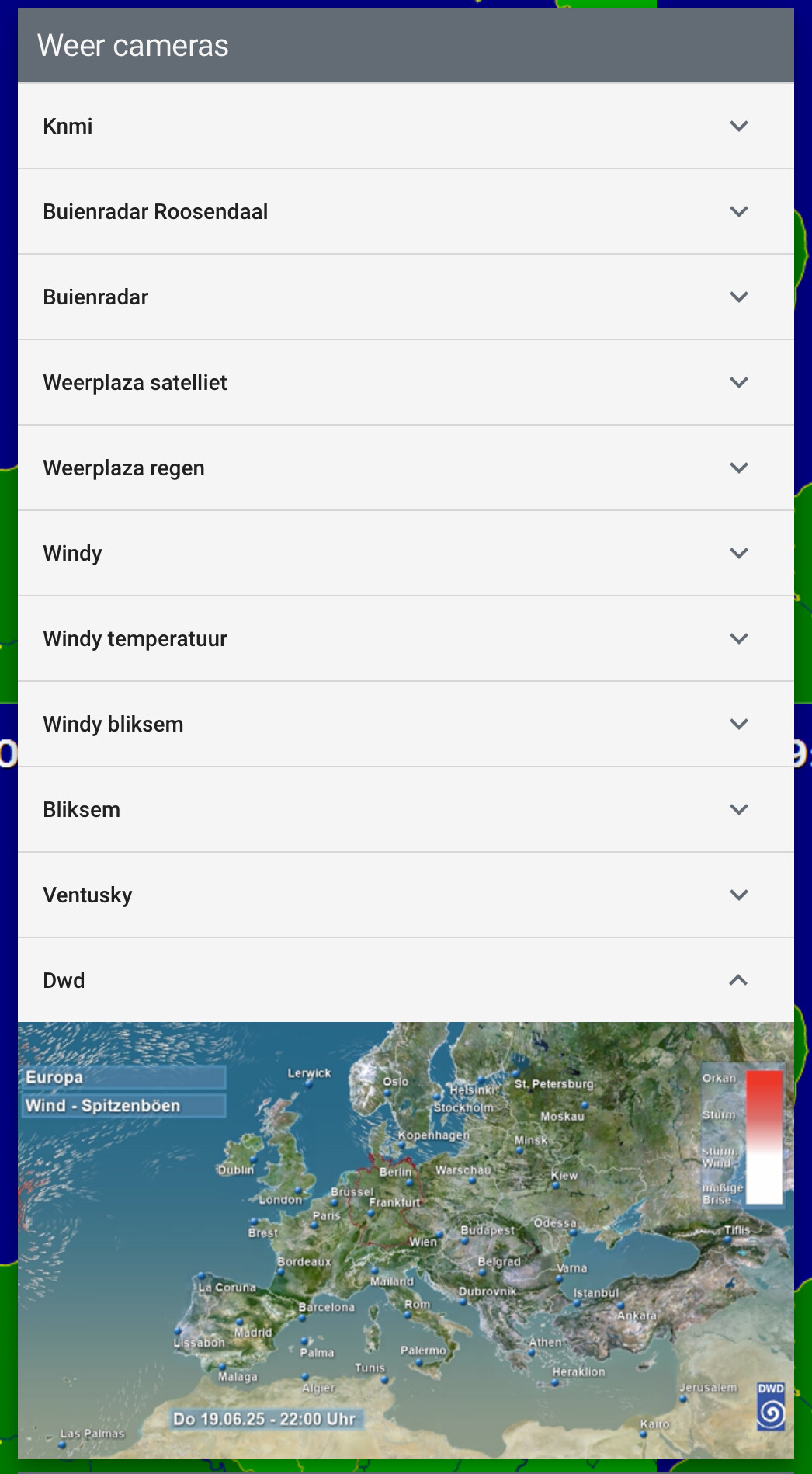

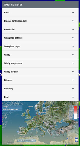

for now, I have even more Loggins on several iFrame weather maps, but those all seem external.
Just try any of the Windy maps in an iframe, or Weerplaza

while the Ventusky is just loading fine
