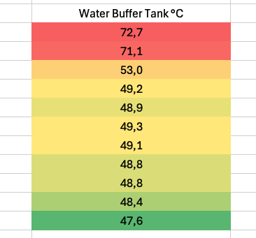

I want to present a set of sensor readings with continuous color scale. Most cards I looked at only support binned colors.
Any idea how I could build a view similar to this quick example from Excel?
(Context: My water tank is equipped with 11 temperature sensors to better understand the energy stored)

These are 11 independent sensors from an ESPHome device. Key challenge is that I want each individual value to be shown with a background color from a continuous color scale ranging from blue to red.
Both markdown card as well as flex-table-card do not directly support continuous color scales, as far as I am aware.
