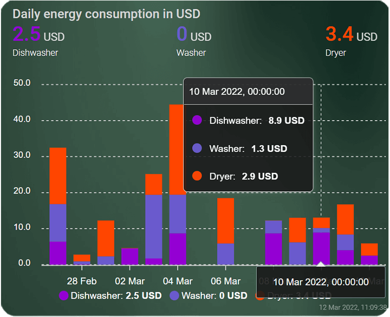

This way, we could build:
  • Monthly bar charts showing energy costs per device
  • Daily/hourly breakdowns for specific sensors
  • Year-to-date overviews with historical comparisons
  • Maybe even correlate usage vs. price spikes
(Image source: ApexCharts Tutorial: Advanced Graphs For Your HA UI - SmartHomeScene)
Instead of just resetting and losing the past values, Home Assistant could store them in a long-term statistics entity or expose them for use in dashboards or export.

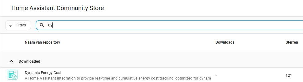

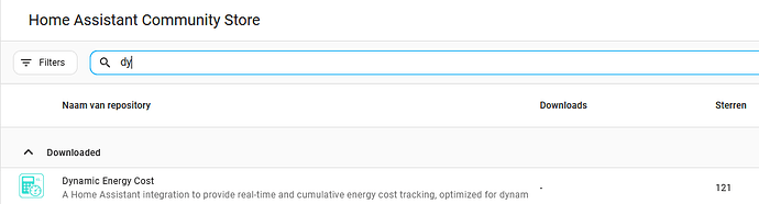

In the latest version V0.8.2 the reset problem should be solved.
Normally you should now be able to find this integration in the HACS store.

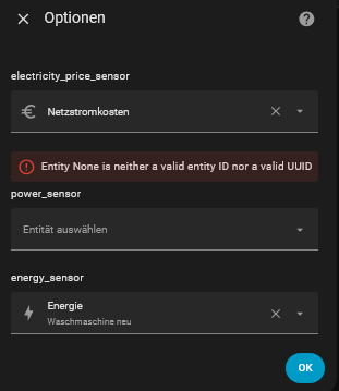

I need some help.
When I try to enter the electricity_price_sensor, I get the error ‘Entity None is neither a valid entity ID nor a valid UUID’.
Why is that?
I used a simple helper input_number.
I also tried it with a sensor.
The error keeps coming up.
Am I misunderstanding something?
Thank you very much.
I had the same error (‘Entity None is neither a valid entity ID nor a valid UUID’) when trying to change input sensors. The solution for me was to completely delete the entry and create a new entry with the new input sensors (for price an energy).
HTH
