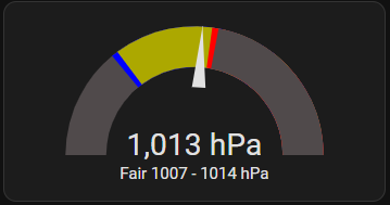

This is what my Lovelace barometric gauge card now looks like:
I love it and thought it might be of use to some of you as well.
