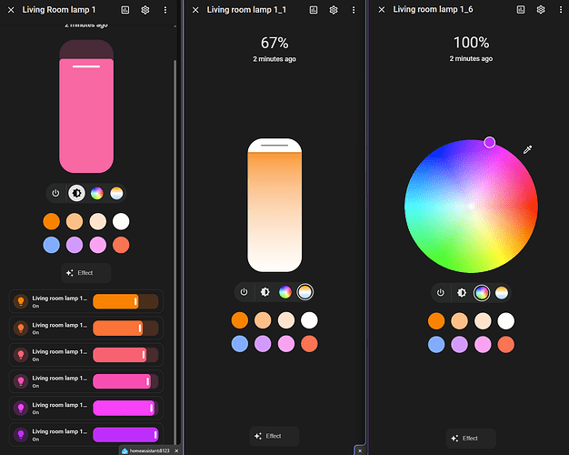

Example 1 - Colour to colour

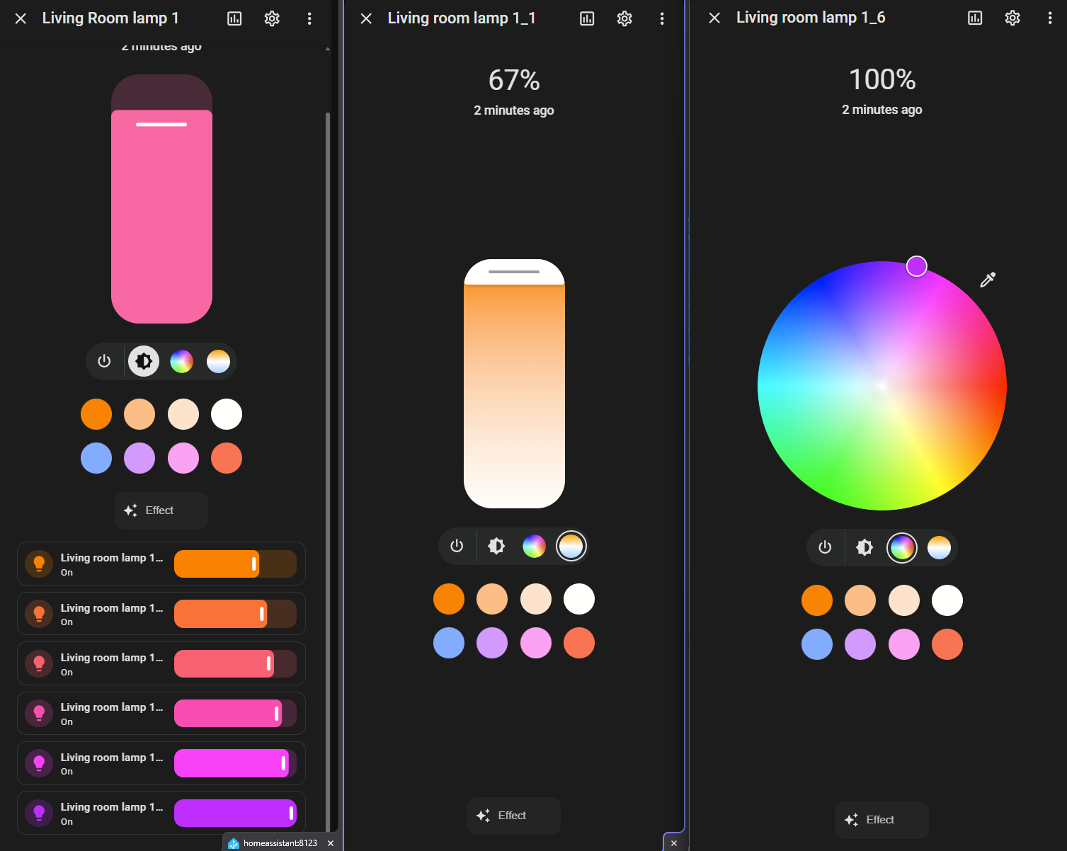

Example 2 - Temp to Temp

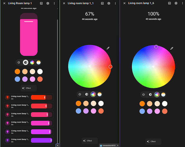

Example 3 - Temp to colour

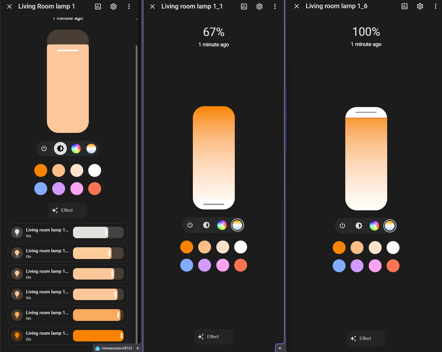

Example 4 - Colour to off
