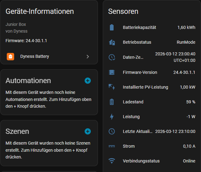

The integration connects to the Dyness Cloud API and provides the following sensors:
  • State of Charge (%)
  • Power (W) — positive = charging, negative = discharging
  • Current (A)
  • Battery Capacity (kWh)
  • Installed PV Power (kW)
  • Communication Status (Online/Offline)
  • Work Status (e.g. RunMode, StandBy)
  • Firmware Version
  • Last Update / Data Timestamp

Tested with
Device Status
Dyness Junior Box :white_check_mark: Tested
Other Dyness models with WiFi dongle :warning: Not tested yet
If you have a different Dyness model, please run the included test script (tools/dyness_test.py) and open an issue on GitHub with the output — I’d love to expand support to other models!

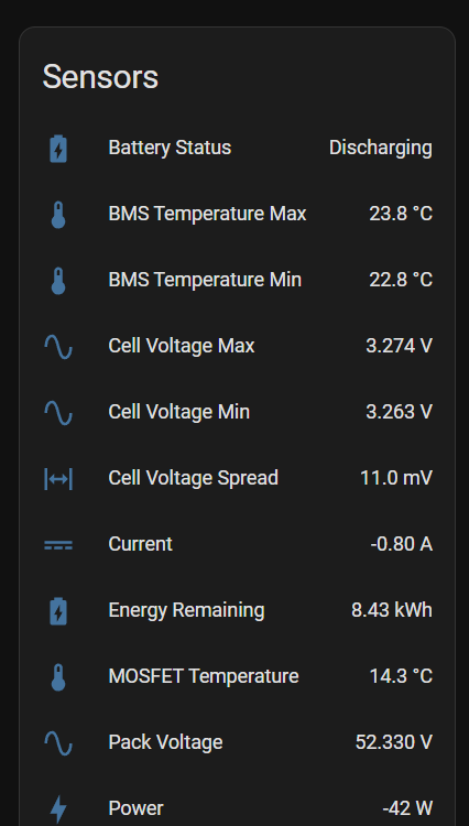

A lot has happened in the meantime. New products are now supported:
Device Status
Dyness Tower (non-pro) :white_check_mark: Tested
Dyness Tower T14 :white_check_mark: Tested
Dyness DL5.0C :white_check_mark: Tested
Dyness PowerHaus :white_check_mark: Tested
Dyness PowerBox Pro-Low :white_check_mark: This should work (community-tested). Implementation coming soon.
A large number of new sensors have been added, depending on the model.
