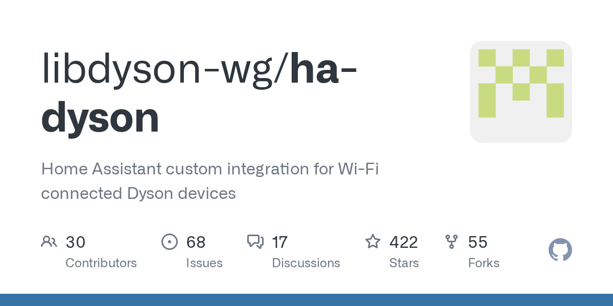

My Dyson Pure Hot+Cool works well, but the integration is a custom (community maintained) one, available from the HACS (comminity, not HA) store:
The hard part is not installing HACS (although that takes a few steps - the docs are pretty good though), but getting the credentials out of the Dyson hardware.
Some kit can be auto-detected, but mine needed the opendyson tool which works well, but needs more sysadmin skills (e.g. command line, install golang, install a module from GitHub, and run).
Under the hood, Dyson uses standard MQTT, but they hide the details from consumers.

Mine is a HP04, but note there are several different forks of the libraries, and HA integration (my link is to the version that is still in HASS as maintained - others were removed).
    model: HP04
    type: "527"
    variant: ""
If you're fine with basic sysadmin (*nix Greybeard here), my notes say...
  • DNF-based Linux box (Debian will likely have different package names)
  • Installed opendyson
    sudo dnf install golang
    go install github.com/libdyson-wg/opendyson@latest
    Logged in fine with creds and email code. ./opendyson login
    Confirmed IPv4 and serials ./opendyson devices
  • Extracted MQTT credentials and used to config the HA Integration
    Worked second time!
The Go version seemed to be more reliable than an (older?) Python implementation.
