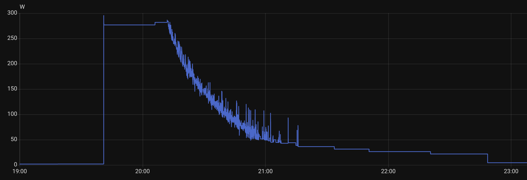

Do you already have a smart plug on the charger? Have you looked at its draw over time?
Here’s charging mine last night:
