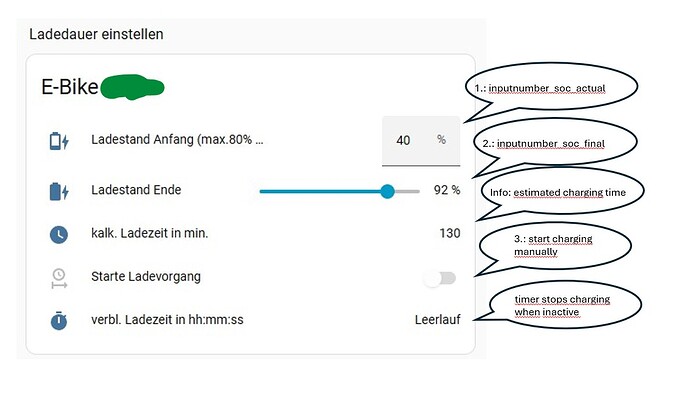

The calculated charging time is displayed in the input-dialogue and when the charging has been startet a timer is active. The timer stops charging when the calculated charging time has passed regardless of the soc finally achieved. The algorithm has proven to hit the chosen final soc almost in every charging process. By setting up the inputnumber it is possible to define max and min-values for actual soc and final soc.

  1. set up the dialogue as an entity-card
type: entities
entities:
  - entity: input_number.pedelec1_soc_actual
    name: Ladestand Anfang (max.80% zul.,siehe Helfer)
  - entity: input_number.pedelec1_soc_final
  - entity: sensor.ladezeitakku1
    name: kalk. Ladezeit in min.
    icon: mdi:clock
  - entity: switch.zwischenstecker_e_bike_ladegerat_1_switch_0
    name: Starte Ladevorgang
    icon: mdi:clock-start
  - entity: timer.timerladezeitakku1
    name: verbl. Ladezeit in hh:mm:ss
title: E-Bike 1
state_color: true
