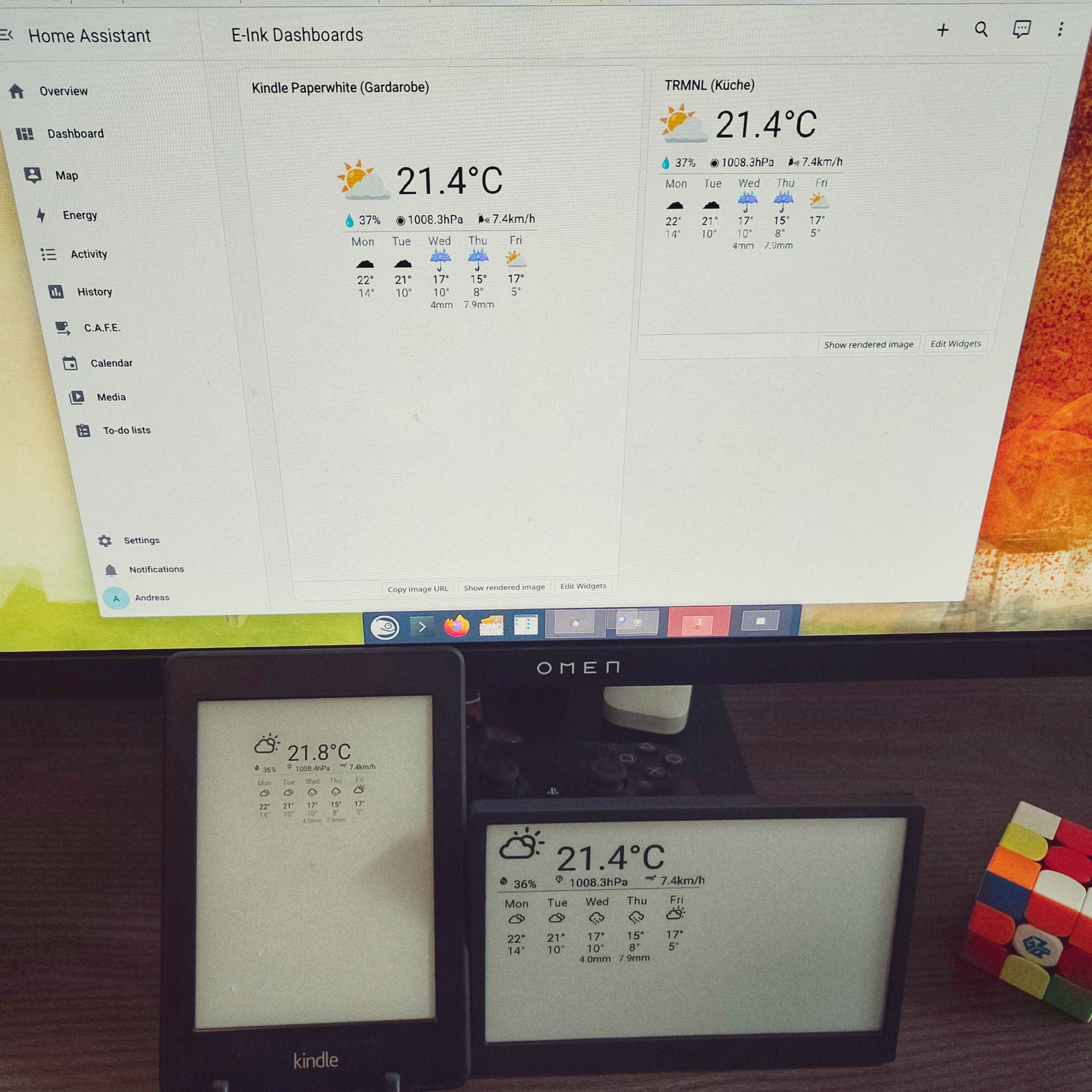

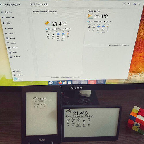

So now I had two different devices that both needed images pushed or
pulled from Home Assistant. That shaped the integration.
What it does
The integration renders your dashboard layout to a PNG image using Pillow
directly in Home Assistant - no Chromium, no ImageMagick, no Node.js. It
exposes the image via an HA image entity and an unauthenticated HTTP endpoint
that devices can poll on their own schedule.
For TRMNL devices, HA can push the rendered image via webhook after each
render. For Kindles (and any other device that can fetch a URL), you point the
device at the HTTP endpoint and let it pull on its own schedule, using ETag
headers to skip the download and e-ink refresh when nothing has changed.

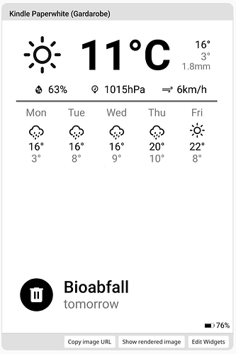

The WYSIWYG Lovelace card lets you edit the layout on a canvas preview that
matches your device’s exact pixel dimensions. You can drag, resize, and
configure widgets and immediately see what the rendered output will look like.
Clicking Show rendered image fetches the actual Pillow-rendered PNG for a
pixel-exact comparison.

I've rewritten the rendering pipeline. Before I had one in python (backend) and one in the frontend (javascript). So you implemented each widget twice and needed to make sure they are in sync. That actually sucks. I thought about using a different language for designing widget. CSS wouldn't work or anything like that.
The solution is SVG. SVG is actually just XML. To make it replace stuff we can use Jinja and have .svg.j2 templates. We just need an endpoint (websockt) to get the final rendered SVG to display then in the frontend. For the device we can rasterize the SVG to a png and do eink optimizations afterwards.
I think this is the way to move forward. I will release 0.2.0 soon and we can start polishing widgets and add new ones.
