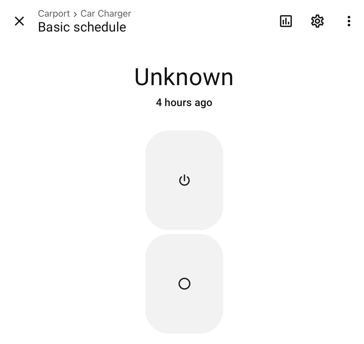

Would like to ask if the basic schedule and weekly schedule are supposed to be in “Unknown” state or maybe I did something wrong?
Thanks!
Does anybody see the same or maybe something wrong with my charger? Both weekly and basic schedule shows unknown - I do have basic schedule enabled. And it is unknown regardless if car is connected or not. I tried to reload the integration and didn’t help. Appreciate your suggestion!

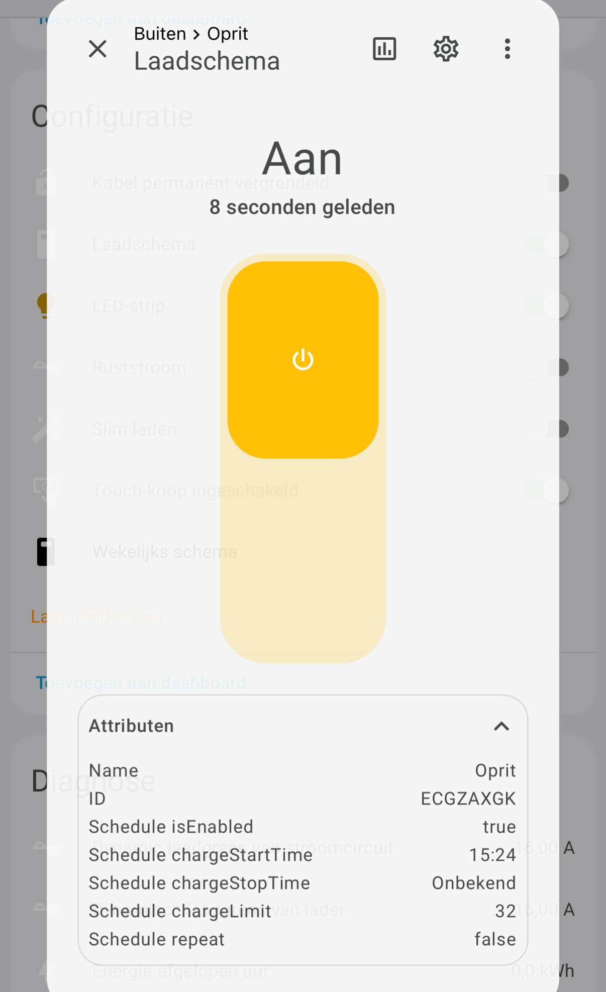

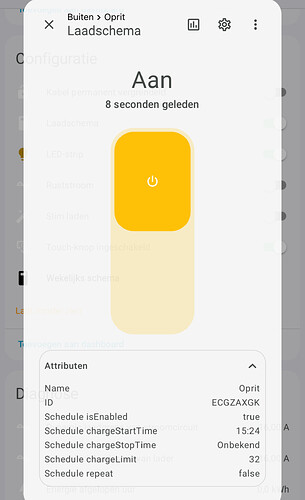

I usually have this switch disabled but I enabled to check. It seems to work for me.
Maybe remove the schedule and readd it?
Hi, thanks for checking and strange it doesn’t work in my setup. There is no error in log and all attributes except for ID are empty…
Ok some further investigation and looks like I can use the switch to turn on/off basic schedule, however it never polls data from Easee so besides name and ID all other fields are Unknown…

Enabled debug logging and follow the trace of schedule I can see below logs:
2025-08-26 17:00:40.435 DEBUG (MainThread) [custom_components.easee.controller] Adding entity: basic_schedule (switch) for product Car Charger, unit None
2025-08-26 17:00:51.979 DEBUG (MainThread) [custom_components.easee.switch] Getting state of basic_schedule
There is no further mentioning of schedule so assume the data never come?

I have created a support case on this: Basic and weekly schedule data unavailable · Issue #636 · nordicopen/easee_hass · GitHub
I have version 0.9.71 installed.I guess the latest version.
But the schedule is created in the Easee cloud isn’t it? So it would make sense it is recreated using the entries in the cloud. My intention was to suggest removing the schedule all together in the cloud, not removing the button inside HA. Because the button in HA cannot be deleted since it is part of the integration.
Removing the integration removes all entities, but since the information is stored in the Easee cloud, it makes sense it readd’s all entities with the cloud values.
Ok thanks for checking - maybe some issue with Easee cloud as I can’t think of anything with HA or integration.
