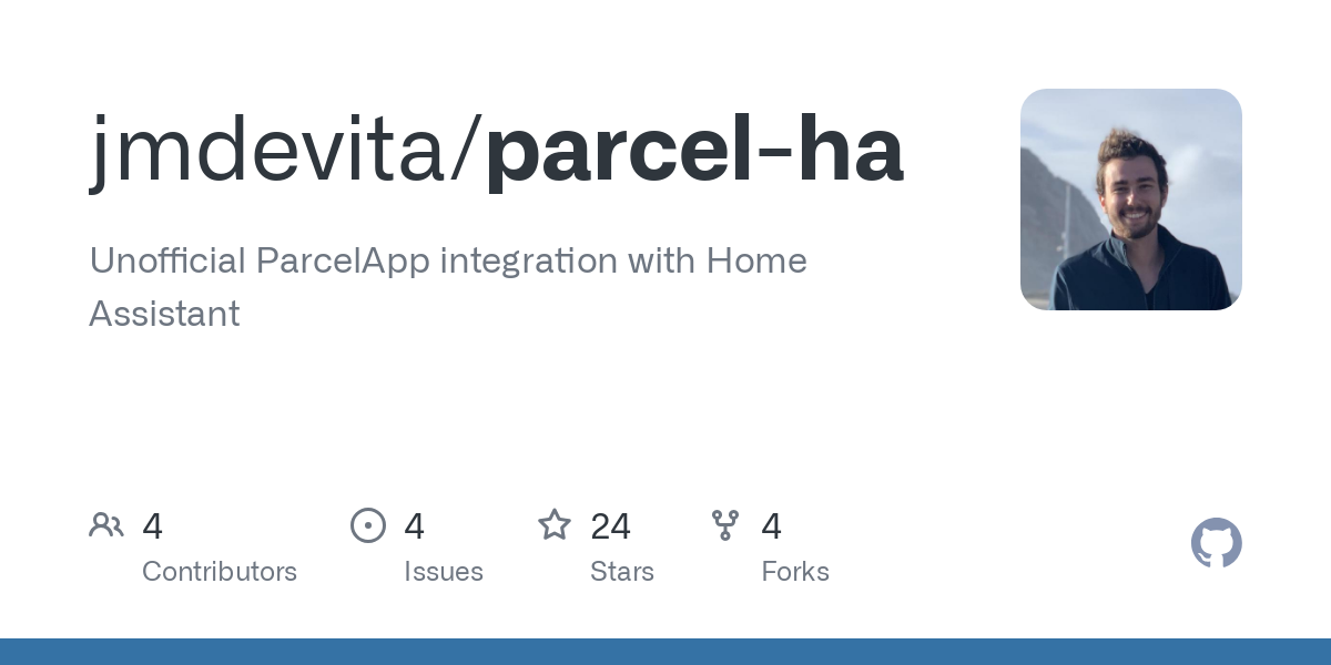

I use Parcel as well. I wrote the developer asking them to consider making a hook or API for Home Assistant, but they were indifferent at the time.
EDIT: Actually, the API for Parcel is available, and a Home Assistant integration is available!
