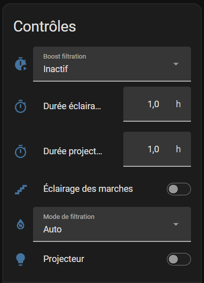

Control — the big one, and what the original integration couldn't do:
  • :arrows_counterclockwise: Full filtration control — switch mode (AUTO ±2h / forced On / Off) right from HA, pump included
  • :zap: Filtration Boost (4h, 12h, 24h, 36h, 48h, 72h) — the real Waterair Boost, with a remaining-time sensor and two-way sync with the app
  • :bulb: Spotlight and step lighting (on/off, 1h–6h duration)

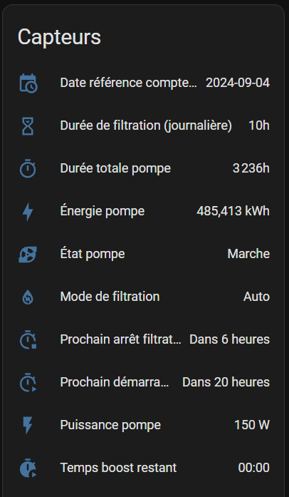

:clock1: Filtration schedule sensors
Three sensors computed in real time from the BPC programme:
  • Daily filtration duration (adapts to water temperature)
  • Next start / next stop → perfect for automations
:zap: Energy monitoring
Enter your pump's rated power (e.g. 150 W) and get:
  • Instantaneous power (W)
  • Cumulative energy (kWh) → drops straight into the HA Energy dashboard

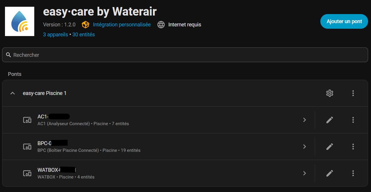

:package: Installation
Available via HACS (custom repository):
:point_right: GitHub - adamotte/ha-easycare-bywaterair: Home Assistant Custom Integration for easy·care by Waterair · GitHub
Configuration is 100% through the UI — no YAML required.
