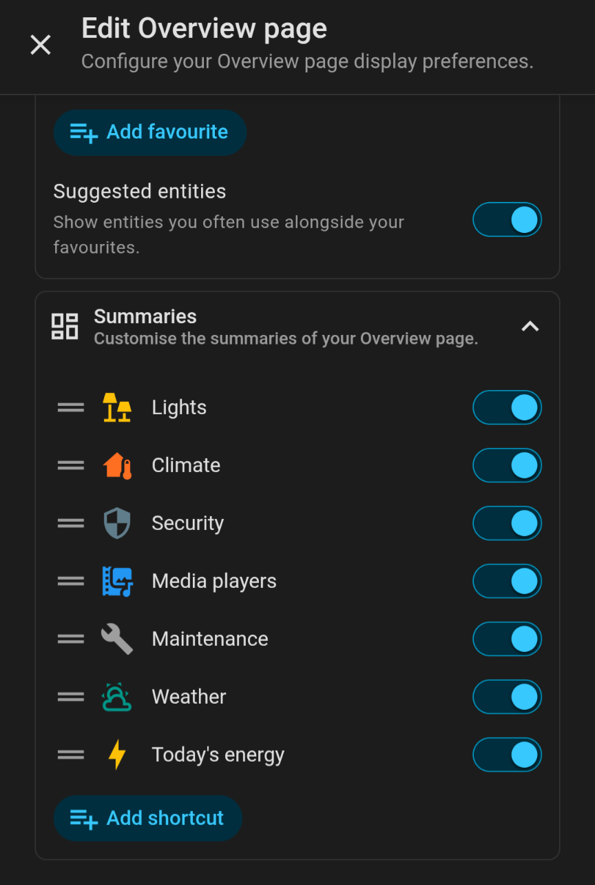

I’m trying to add a shortcut to the Overview but failing. I click Edit dashboard, Add shortcut, paste in /config/zha/visualization, click Add custom path…
There’s no error but the list of shortcuts remains the same. Any ideas?

I’m not creating a card, I’m editing the overview and using it’s UI to try and add a shortcut, as in the image in the OP. I’ve not created it edited YAML in those areas, so it should be as it was meant to be.

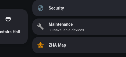

I’ve tried all 3 of the suggested solutions and they all work. You might be missing a / at the beginning of the custom path ( /config/zha/visualization) if you’re typing it in manually

Overview > Edit
Shows:
Add Shortcut - gives me a search box with four categories. Nowhere in those categories is /config/zha/visualization so I type it in and accept by clicking on it underneath the search box.
I then return to the above screen which hasn’t changed. I was expecting it to be added to that list but maybe I’m supposed to see that GUI.

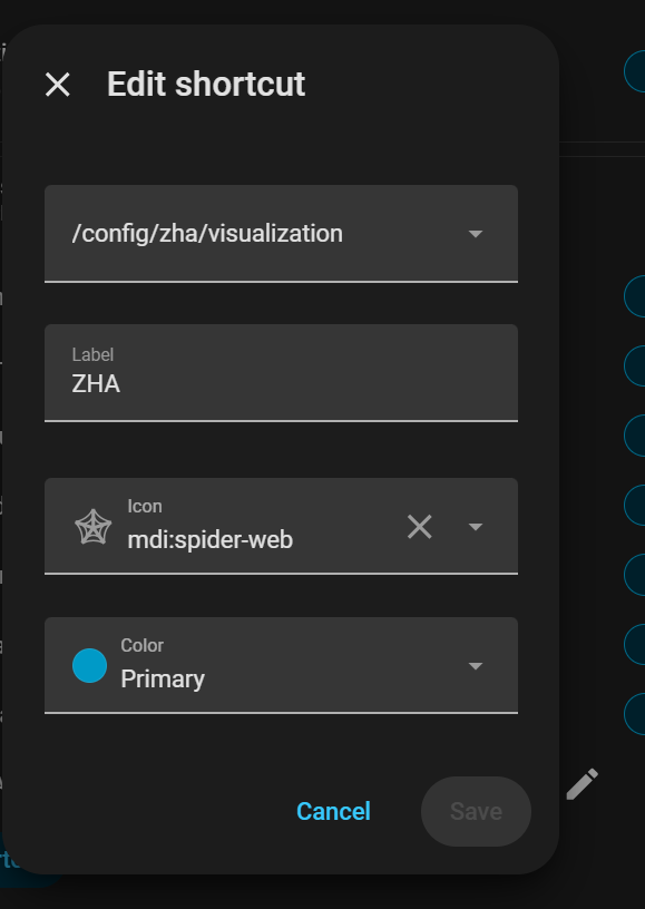

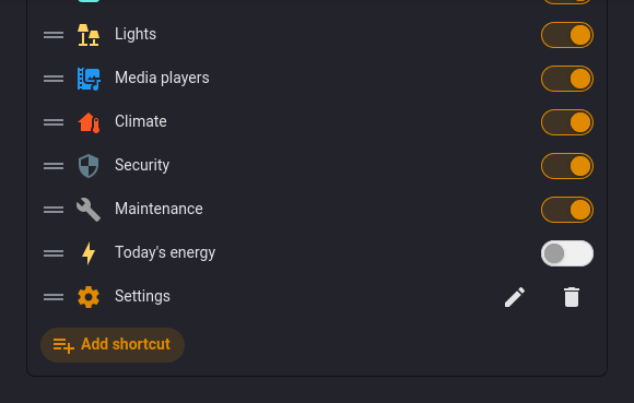

That’s expected.

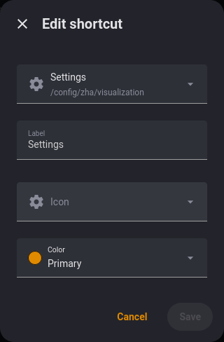

When you first do it, the new shortcut will be labelled “Settings”:

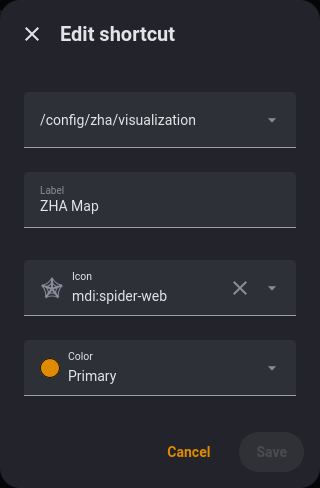

You can click on the pencil to edit it’s name and other details:
If you’re not seeing anything like what I’ve posted above… are you sure you are using ZHA and not Zigbee2MQTT?
Thanks, that’s it. If the new shortcut wasn’t named Settings I’d have realised this myself. Calling it New or Custom or almost anything that is not already a thing would be better. Instead it’s disguised as an existing built-in feature.
