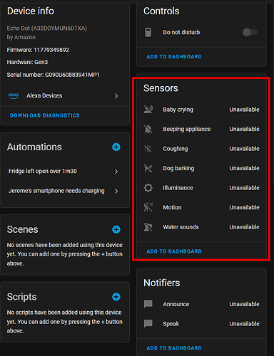

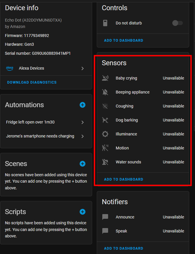

More sensors are coming to the 2025.7 release.
Just installed 2025.7.0b3
I see a bunch of new sensors on my Echo Dot 3 for instance, most of them unavailable though.
(same on an Echot Dot 4 with clock)
Nothing media related on the horizon yet (apart from the speak/announce)

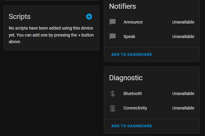

I restarted my HA this morning (a few times now) and all my AMP entities are unavailable.
anyone else here seeing this?
I did see in another thread that others are experiencing the same but I figured I’d post here in the official thread as well since no one has reported it here yet.
It seems that Amazon is performing maintenance on the servers. This error is also appearing on Alexa devices.
so if you still had a working AMP or AD dont you dare restart you home assistant or integration or you will be unable get a token
well that sucks.
hopefully it’ll come back soon? Any idea if it will fix itself after the service is restored (and another restart) or will we need to nuke our AMP integration and start over from scratch?
not sure i guess it will solve by itself , but if amazon decide to change the api for the new Alexa+ maybe this will break all the integration that use it (hope this not the case)
It appears to have screwed the official HA integration as well.
Doh, Just noticed the above issue was for the official HA integration!
I nuked my AMP and tried starting over. No luck, Amazon is not sending me any of my echos, firesticks or firetv’s.
